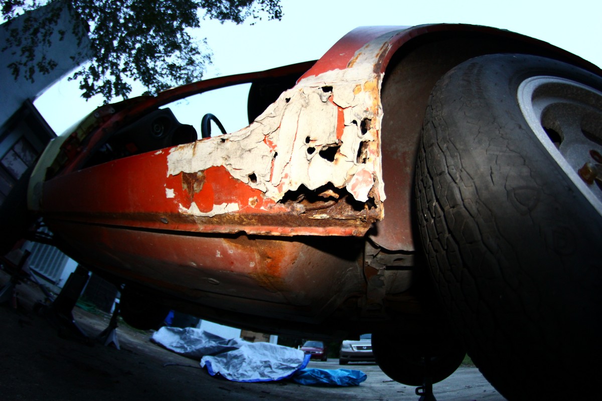

First we have rocker rust...I've seen worse and I figure this will be the least of my concerns. It's covered by a lot of bondo but looks to be just the outer rocker.

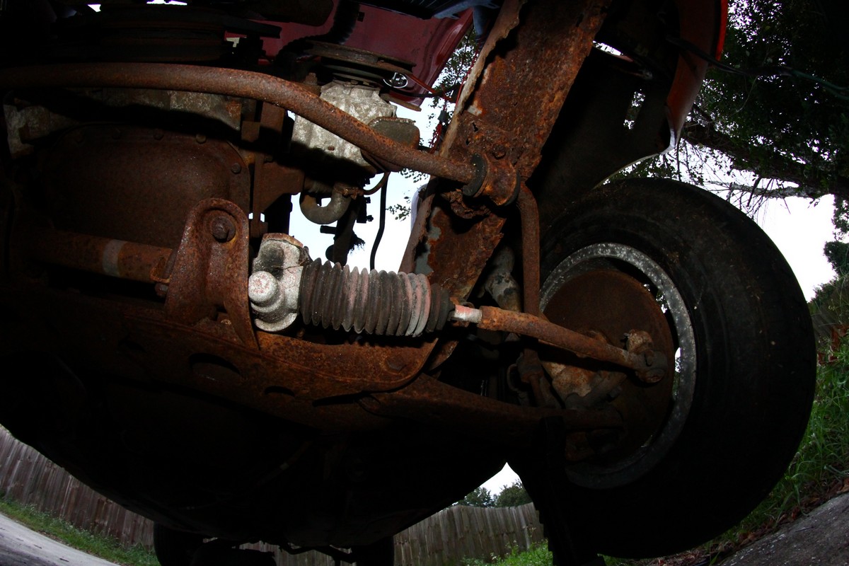

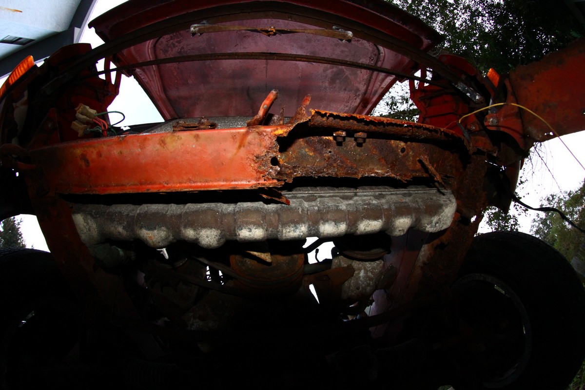

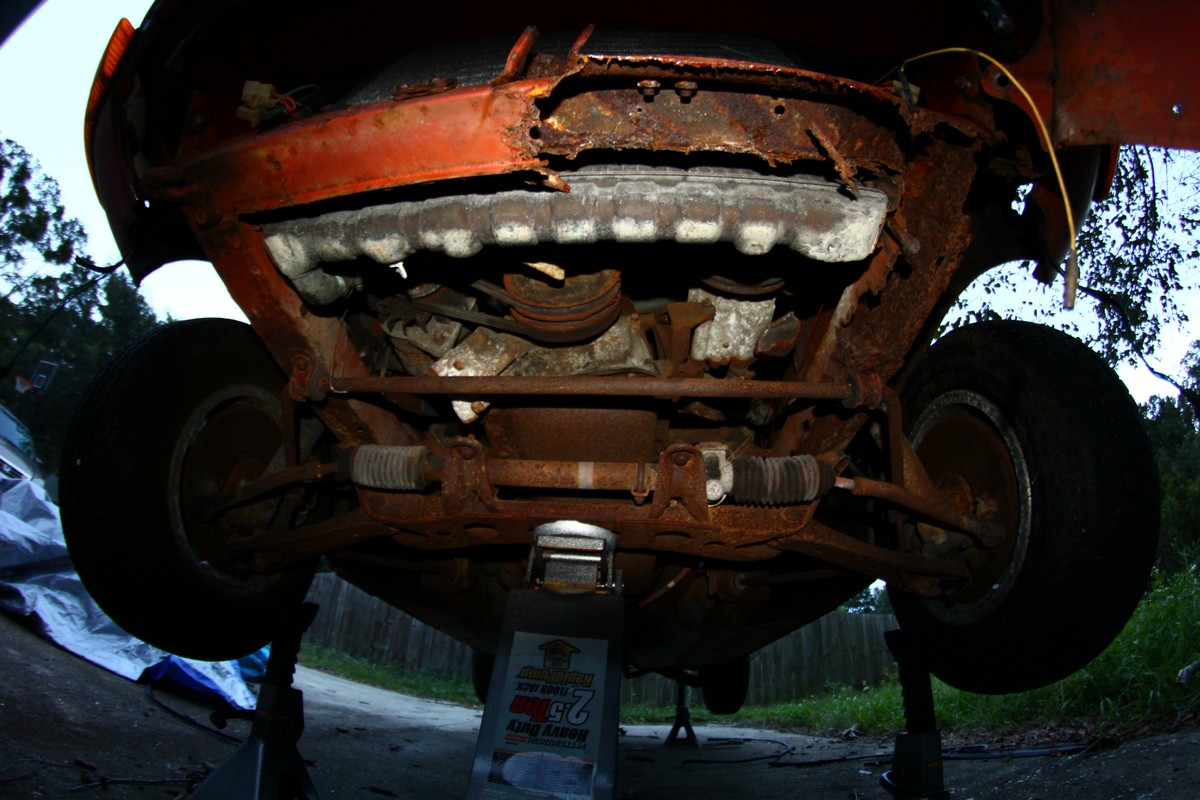

Next we have nasty nasty front rail and core support rust. Forming the patch seems simple enough (in my inexperienced but ambitious head), but it does go back past the swaybar mount, maybe 5 inches or so and really needs to be patched (or replaced) on all three sides. The only metal not rotting is the upper portion

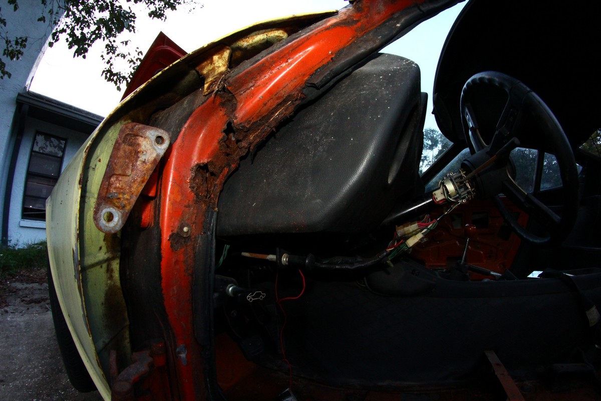

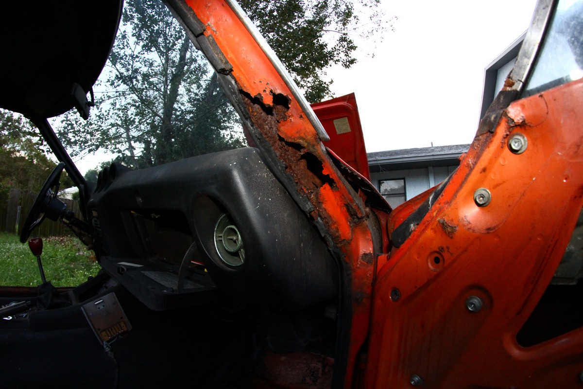

My next main concern it where the a pillar meets the frame. I have an old timer body man that i know that swears he could fabricate what would be needed to replace this properly, but I am warry. I havent gotten the fenders off yet to see the extent, but the roof is like this on both sides. Just purely rusted through the a pillars to the frame. Is this even fixable!?!

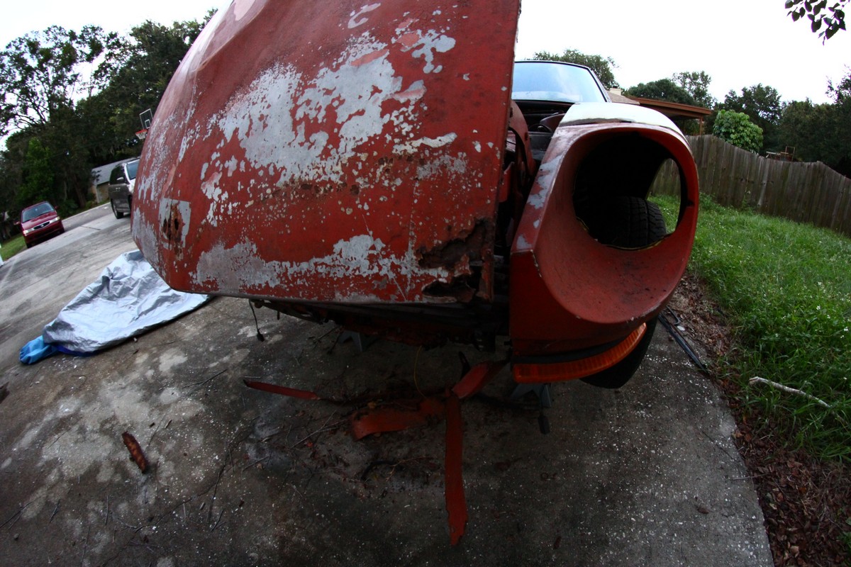

I also have a corner rotted out on my hood. If it is simple enough to fix i would like to, as it isn't easy finding a hood in my part of the country.

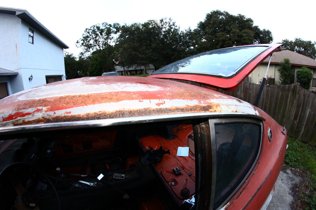

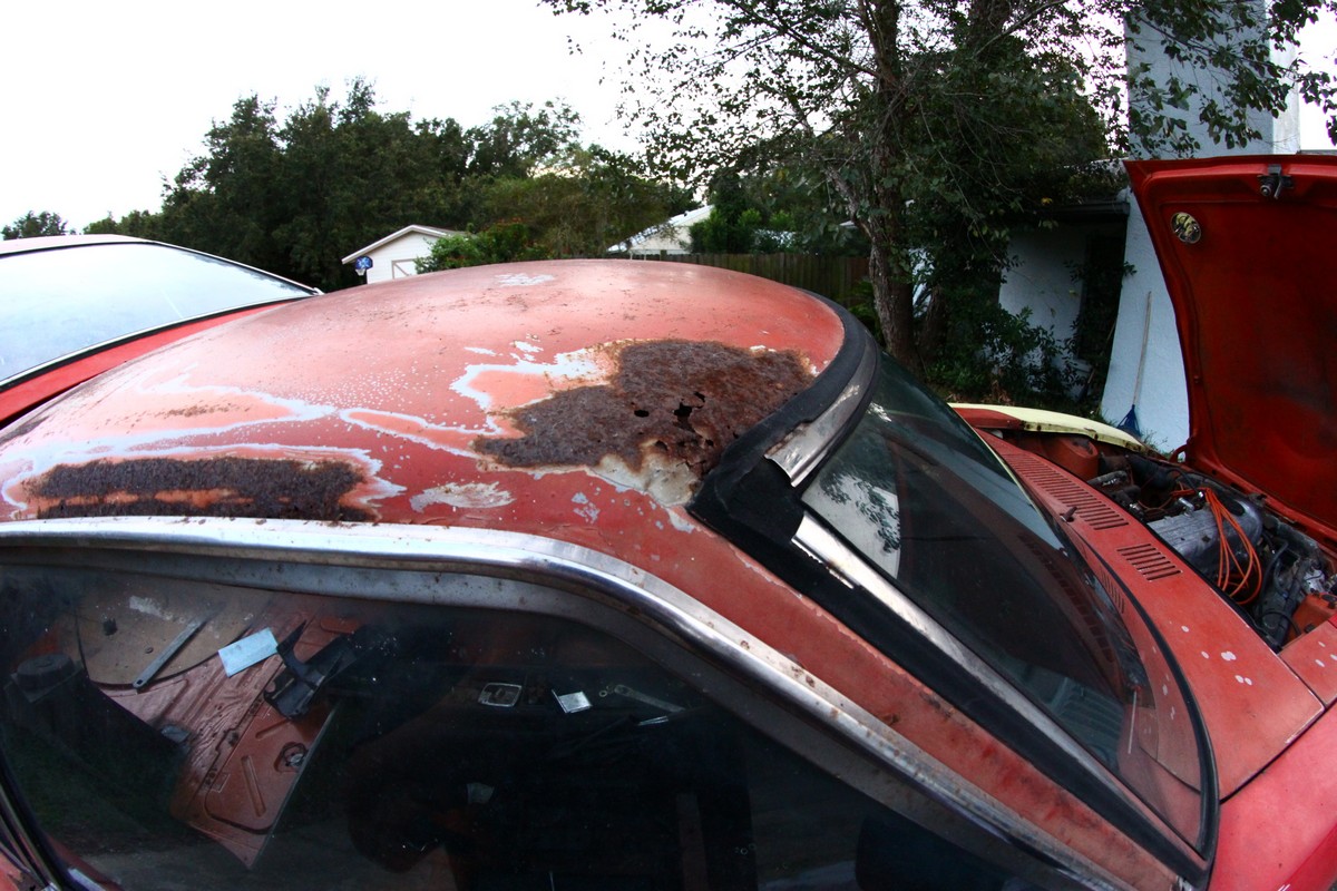

I also have some roof rust that I am hoping can be fixed with patching once the headliner is removed. Or is that I bad idea. There are more spots on the roof than I took pictures of, and they are all near the edge, but dont seem to be too widespread.

So $15,000 is your max?
I just quickly browsed through a few items on zcarparts.com and it looks like if you start buying repair panels from there, you'll quickly pass $15,000... You might want to consider looking for a second car for body parts. You will probably end up paying a lot less money for it and still get a lot of stuff you will need.
I think that car needs to be dismantled. You'll want to identify every hidden problem area.

It is going to be a lot of work but stripping it down and sand blasting everything is a must. You should have one of the best years of the 240Z as far as carbs go. The bumpers on the 70-72s also sit closer to the body (I have a 73 and switching over to the 70-72 bumper mounts) Getting a doner car for the parts is a better idea if you don't want to spend all the money. The rockers, roof and underneath are repairable with some work. Make sure you get a reputable welder to do the work in those areas or you will see it in the finish. I would find another hood, fenders and any other parts that can be taken off and replaced easily. If you want all of the metal to be just this car then you are well over the $15000 for a finished car.

I don't condemn it. I think it's frickin awesome. I think any process where we learn anything is worth something. If it brings you closer to your grandfather and gives either of you the smallest bit of joy without costing anyone any pain (spending mortgage $$ on parts) then I think it is fricking awesome. I am also a big fan of NOT sending cars to the crusher. ESPECIALLY z's.
BUT I would maybe gently approach the idea with grandad of finding a z with less rust to drop all the awesome stuff into. That is A LOT of rust. It can definitely be fixed but I think most body guys in this day and age don't wanna do that kind of work. Most of them are working on peoples cars that have to go back on lease and need a few dents fixed and some quick easy 2 stage paint before the lease man rapes them again. We live in a disposable society and that's just part of the effects. I went through HELL trying to get someone to weld the floor pans in in my Z and that was 1999 or 2000 in the north east and I knew EVERY mechanic and body shop. It's gotta be harder by now. And what makes it worth if it was a 68 camaro or a 67 Mustang or whatever they'd be more likely to work on it I think.
Frame rails and that pillar is structural. The 71's were kinda lean on safety to begin with. If they're not fixed properly and you crash it's gonna be ugly. Make sure whoever does it understands structural systems. Its all well and good to do things on your own, but sometimes people think they're exceeding safety standards or improving strength and they make it worse. For example, an improperly installed roll cage can be more dangerous than no roll cage. Have someone who's done structural stuff help you if you do completely re fabricate this z's body. And while I don't like seeing Z's go to the crusher I don't like seeing young mechanics with an appreciation for Z's go the the hospital either. Cars structural and safety systems are important. It wouldnt take much to make a stock 71 more safe. Theyre pretty dangerous in crashes. But with all that rust its a real issue.
As far as hoods go if yours is that bad and you want a hood from a 78 (vent holes) with light rust I will give you one when you're ready for it. Free. It's in NY at my moms house. She'll be glad to see it go.
