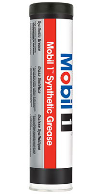

Mobil 1. Squeaks drove me nuts last year, had my rear end apart at least 5 times. Got some mobil 1 synthetic, and its smooth sailing. Wiggle your exhaust? Before you start taking things apart I guess, but mine was for sure A-arm bushings.
