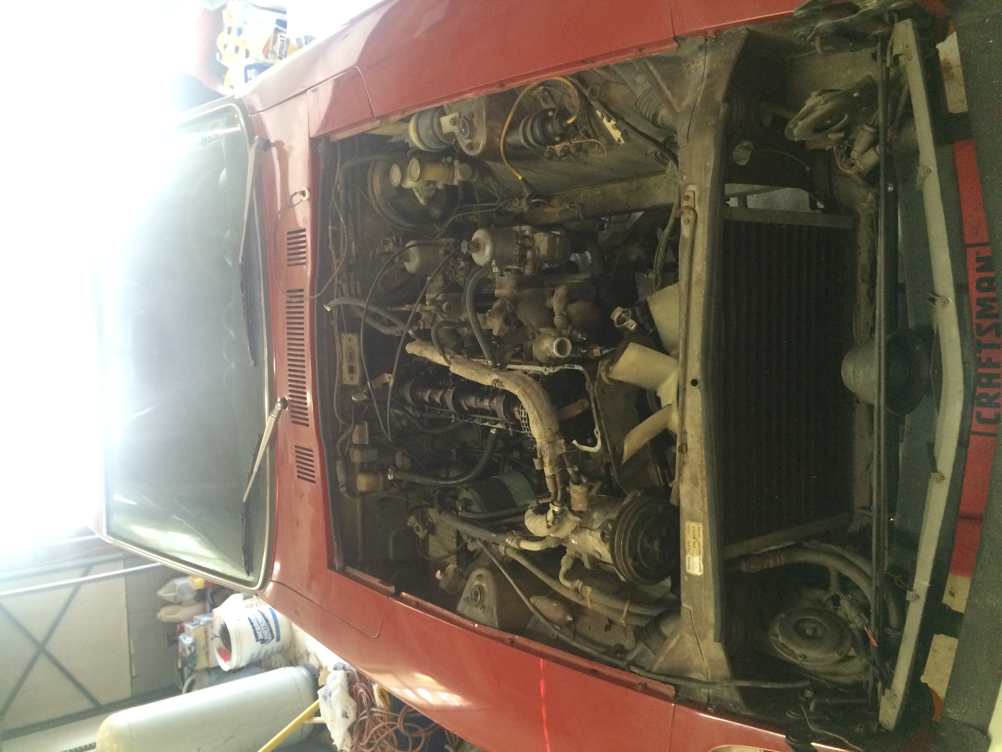

Brand new to this forum, thought Id ask for some insight on my 74 260z. Blew up the engine a few years ago (not literally but the main bearing is shot) Ive started the process of removing the engine, taking out the radiator, air cleaner, sensor wires & hoses, working on carburetors currently. Is it worth it to try and rebuild it at this point or find an alternative? Im not sure of a budget at the moment, kinda just playing it by ear and figuring things out. Any suggestions are appreciated!
Hi Joey, welcome to the forum. Tell us more about your 260Z, post some photos if you can.
What is the car's condition and what do you want to do with it? Is it a daily driver, autocross, show car, track car?
What's your skill level? Sounds more than beginner but from there can't tell. Maybe it's more like what's your comfort level about taking on a project.
There are all sorts of motor options with these cars. They range from staying with an original matching numbers motor to dropping in LS series V8. In between could be installing an L28 from a 280Z or ZX and so on. It all depends on what you want to do, your skill, the time you have available and of course your budget.

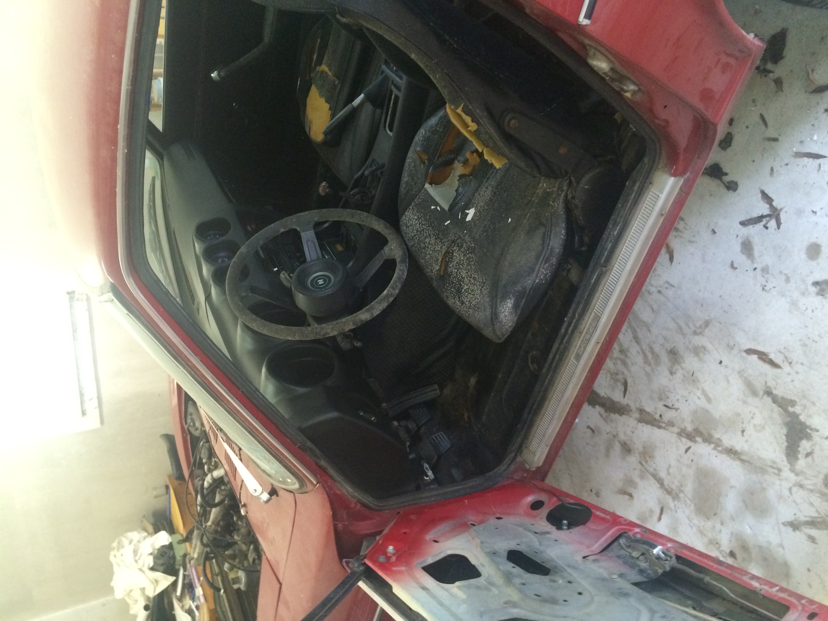

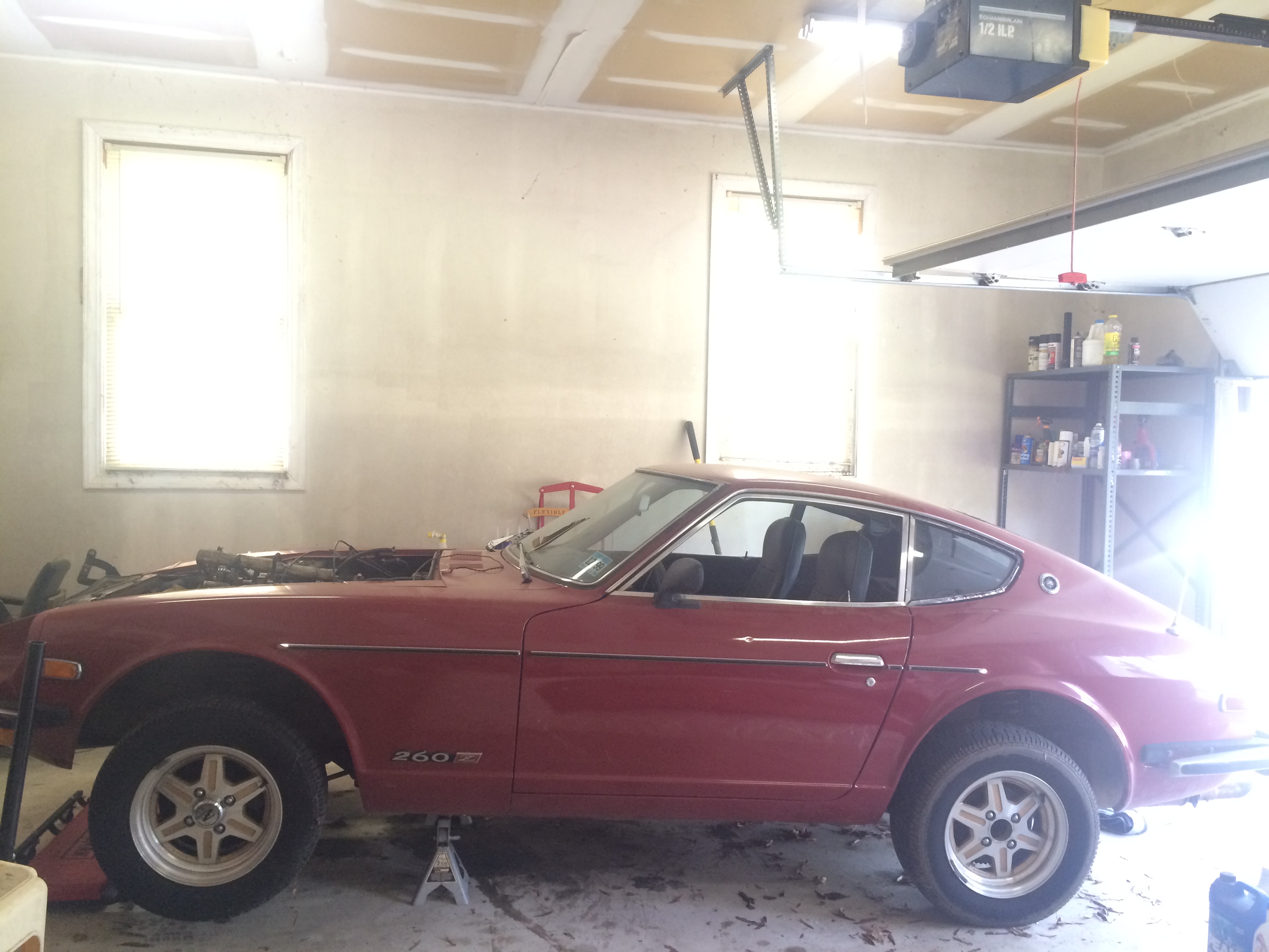

The exterior of the Z is in pretty good shape minus a few bumps. The interior needs a lot of work, tears in the leather seats, a few cracks in the dashboard, hole in the floorboard. Its been sitting for about 5 years so of course its got rust in some places.
I really want to get it running again, it was a daily driver driver but im wanting to make it a daily/show maybe even a track car. Just enough to drive it around and take it to some car shows with friends. It was my father's car before handing it down to me. Everything is original however, it was repainted red (from its original tan/brown).
Im no expert thats for sure but a beginner or novice at most. I've done minor work like changing the brakes/pads out, nothing with the engine until now. Im definitely up for making it a project! I considered rebuilding the L26 or swapping in a L28et, RB26, or even a 2Jz.. if I can get my hands on some more money.
College kid here, my parents are all for fixing it up and will help where they can (financially) but it is ultimately up to me to pay for it. So far ive been following the manual and getting tips from anyone I can on how to take out the engine/rebuild it, although I haven't gotten to actually taking the engine out yet.

Very nice. Looks from the photos like a solid car. L series motors are pretty bullet proof if taken care of. If you just want to drive it, IMHO, get the existing motor fixed. Looks like the carbs have already been changed to the round tops - that's good!
This may be a loaded question or just rhetorical.. but Im real close to being able to pull the motor, I just need a hoist really everything has been disconnected from the engine, getting ready to disconnect it from the transmission.
In order for a rebuild, is it a good idea just to replace every piece inside the engine? or just the parts that are worn down.. also Is this something I can just do myself or is it depending on the damage that I will say, "have to take it to a head shop"?

As far as the rebuild goes, I'm not experienced there but ... I just gotta say that head shops today don't specialize in car parts.
If you've got the head off and have the budget, might be a real good idea to take it to a machine shop.... even take the block and get both sides worked over.

Ah! I haven't replied in a while, caught up with work and cleaning out the garage for space to put the engine... once its actually out. I started disconnecting the transmission to pull everything out together, however I was able to get in touch with someone about a 280z and 280zx
I found a l28 engine from a 77 280z, 114k miles, runs smooth, he's already taken the engine out to do a v8 swap. The guy wants $600 but might be willing to negotiate. I also have a neighbor with a 280zx, all original with 240k miles on the car. Haven't really talked to him about the price, it almost seems worthless to pull that engine from an already running and in good shape car. What are your thoughts on swapping out the l26 for the 77 l28?
