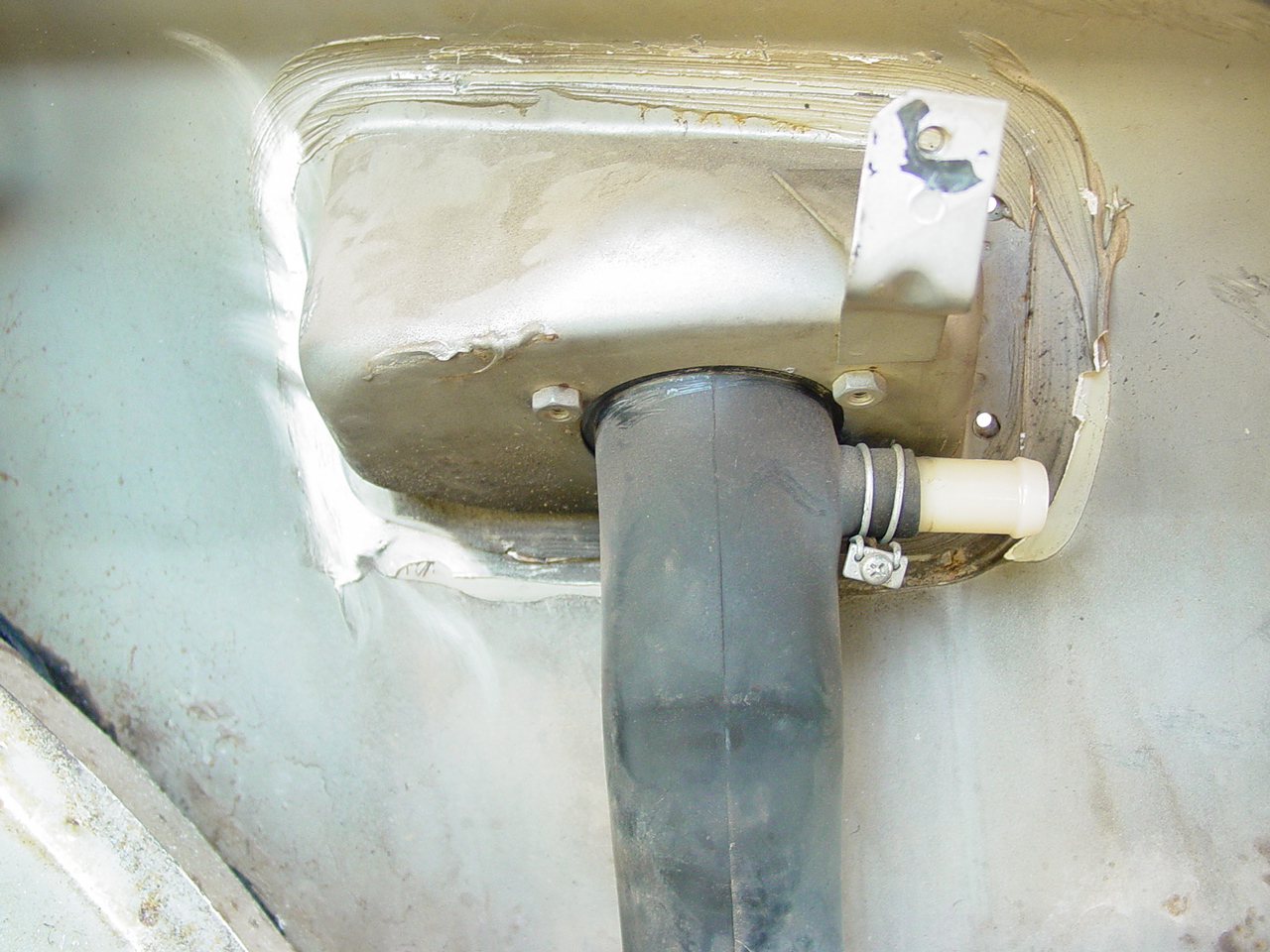

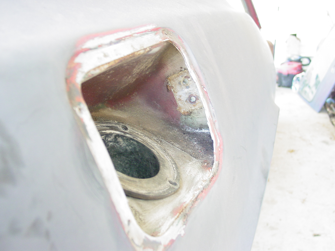

Sorry guys, I'm new to the forum thing. I should have mentioned that there is nothing left in the car, we have removed the gas tank, fuel lines, all suspension and rear end, all interior. It seems like the fuel filler tube can't go down b/c of the lip on the tube itself as in DSC04649.jpg but it cant go up b/c the plug on the right as in DSC04650.jpg.
Thanks for the help.

Okay, now we're on the same page! Remove the plastic connector and squeeze the hose inward and work it out the top hole. Might need to heat it up with a heat lamp but that's the only way out.

i am in agreement with theramz. looks like your filler hose is slightly different than mine. warm it up with a heat lamp, squeeze the tube right below that fitting so that the nipple points down, then just press the nipple down against the hose and work it out of the hole. no big. good luck. and throw a few more pics of the car up. i wouldn't mind gettin a better look see at this car of yours. if you don't mind.

Thanks guys, got the fuel hose out using a little heat from a hair dryer.
