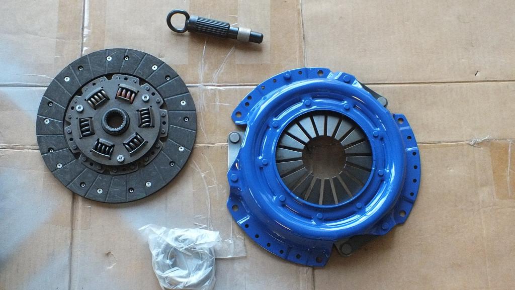

Got an Autocom stage 1 clutch kit for the new engine as well. Going to be pulling the engine only with the trans still in the car.
