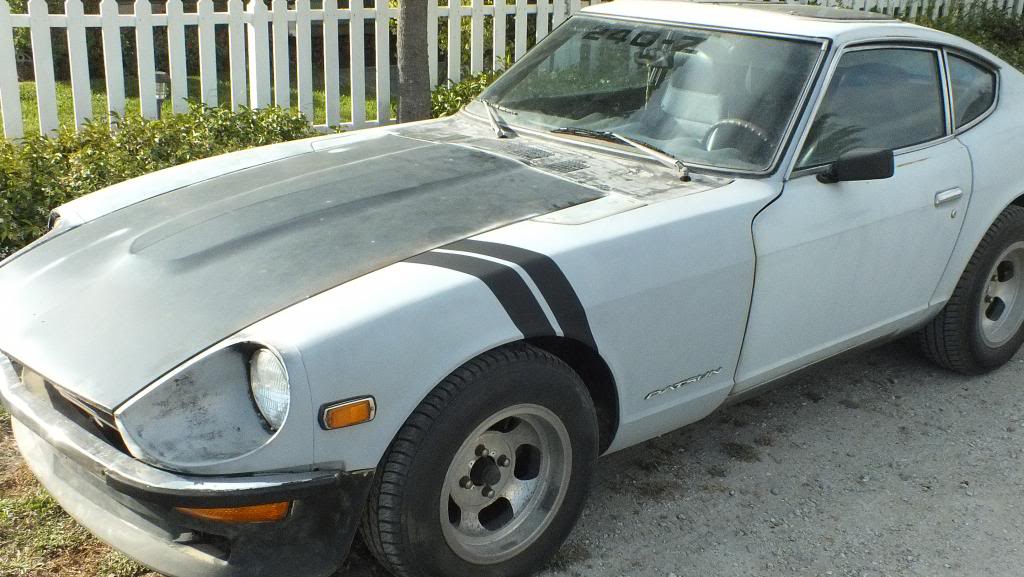

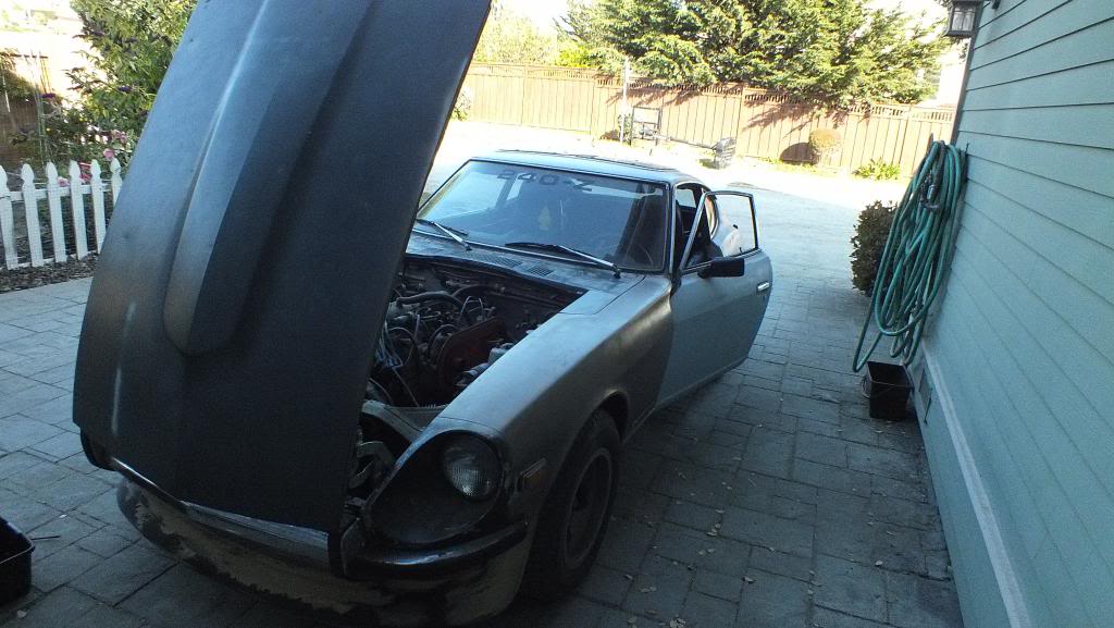

Just got her today. Those that saw my teaser post kind of have an idea of what i bought. But for those who haven't, it's a Series 1 240Z that has been sitting for 3 years, due to the PO having lost the keys to it. Paid only $1600.
It came with a TON of spare/original parts for the exterior, engine, and interior. Being a Series 1, it has the rare E31 high compression cylinder head (9.2:1) vs later years having the E88 Head (8.6:1).
Another reason for it sitting was due to a cracked radiator that the PO never got around to replacing.
It has a 5-Speed swap (FS5W) from a 280ZX, though for some reason they had to cut part of the trans tunnel and center console to fit the shifter... Not sure why that is. It's also got some badass vintage twicepipes.
There isnt much rust either. The underside is very clean, with just a bit of surface rust on the front bumper and steering rack assy.
There is some surface rust on the body as well, but that can easily be sanded off.
The first step is to get some keys made, so i'm having a locksmith come by early this week to sort that out.

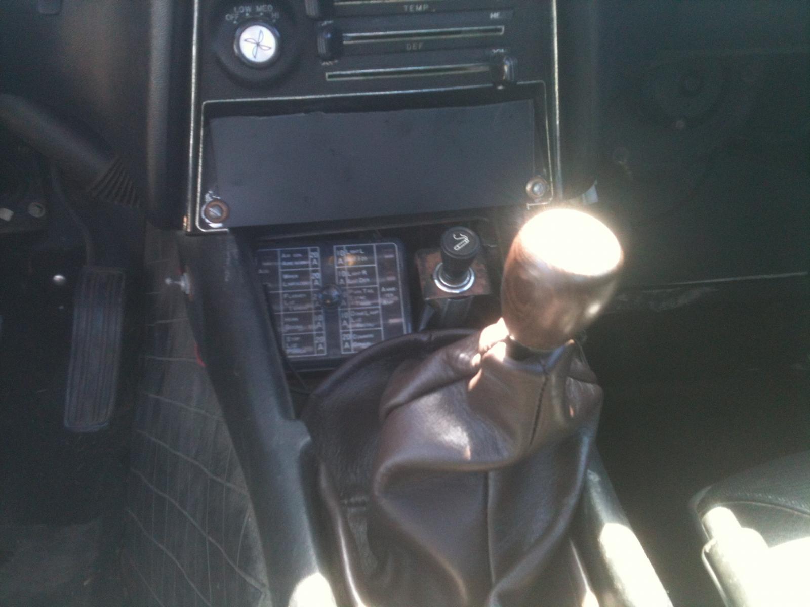

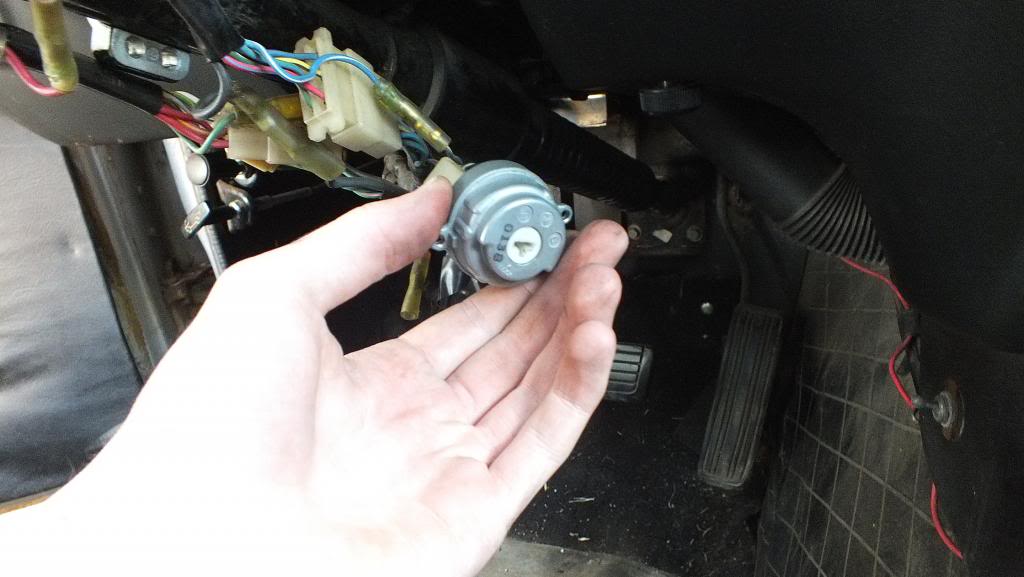

Started working on her a bit today. First thing I did was work on the interior a bit. I slipped on a spare leather shift boot I had laying around, and fabricated a cover for the stereo slot to cover up those nasty wires.
Then, I worked on removing the old nasty battery that puked acid all over the battery tray, making it rusty. Luckily I found some rust remover that I will use to refinish the area to prevent any further corrosion.

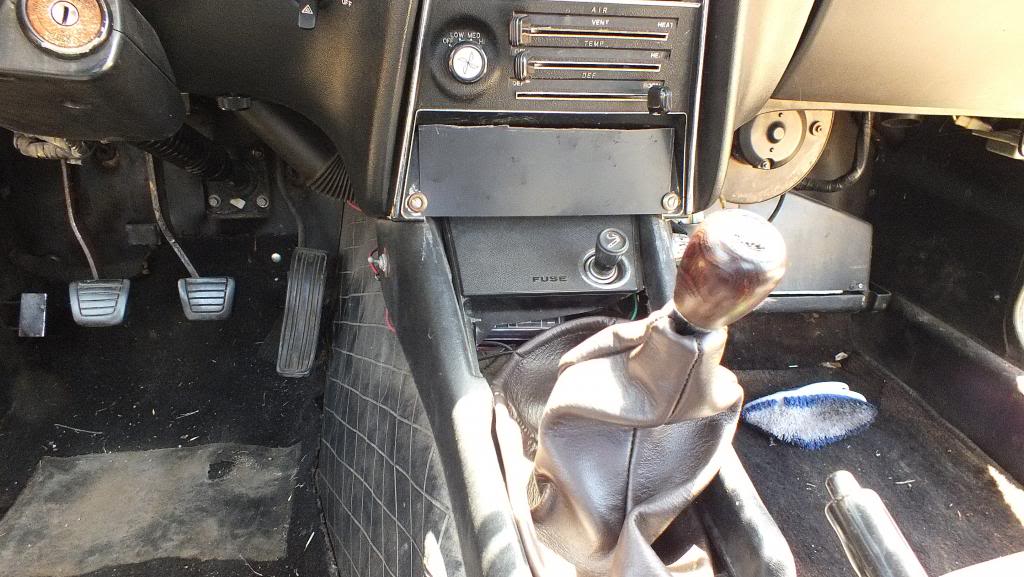

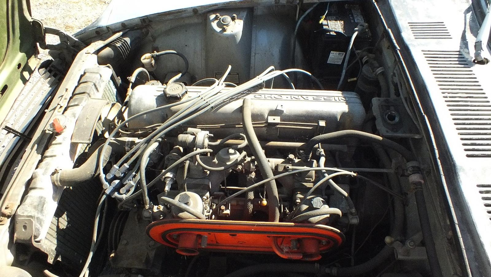

Here's a better pic of the improved center console area.

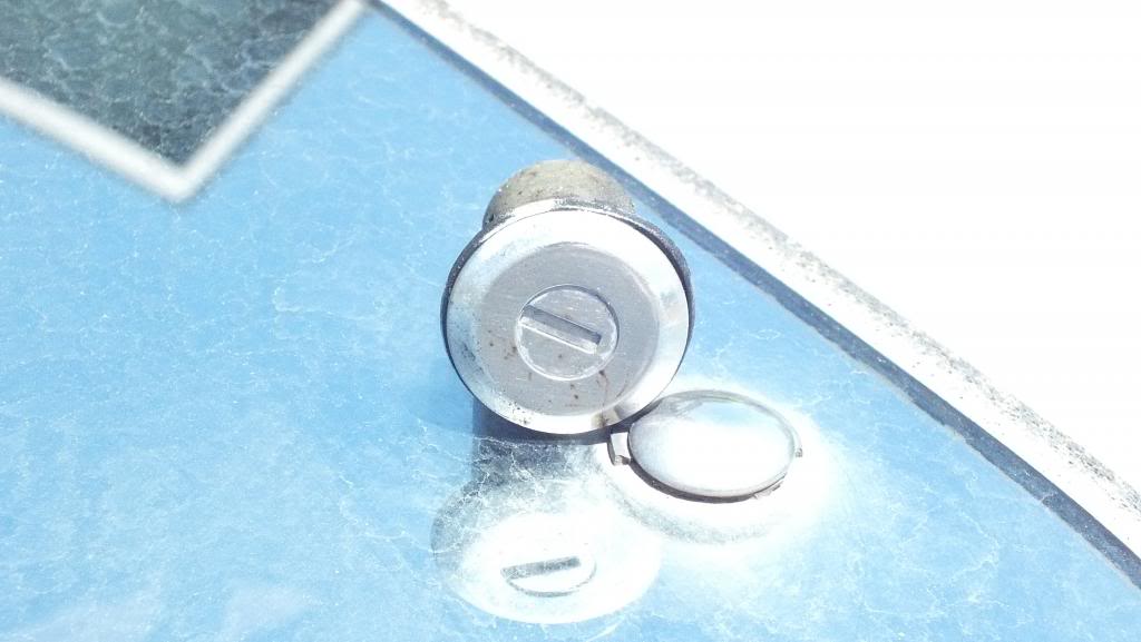

Also pulled a door lock to send in and get a key made.

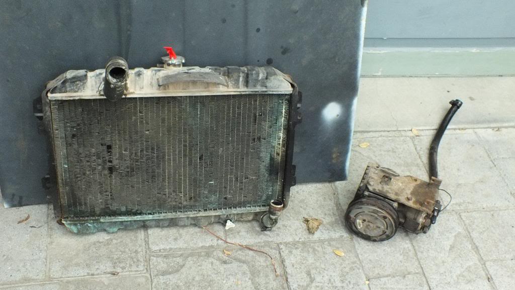

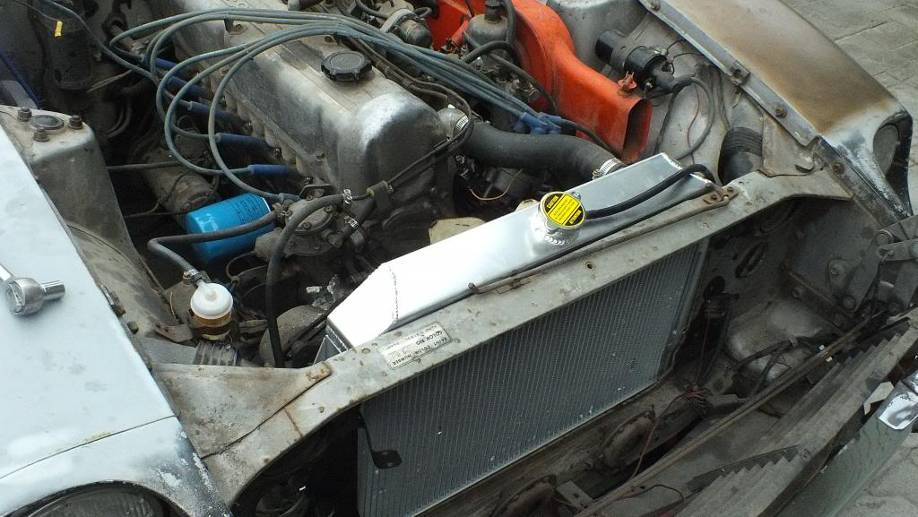

Changed the oil, gave the engine a full tune-up and replaced the totally rotten radiator.
It's an aluminum two-row i bought for $130 on Ebay.

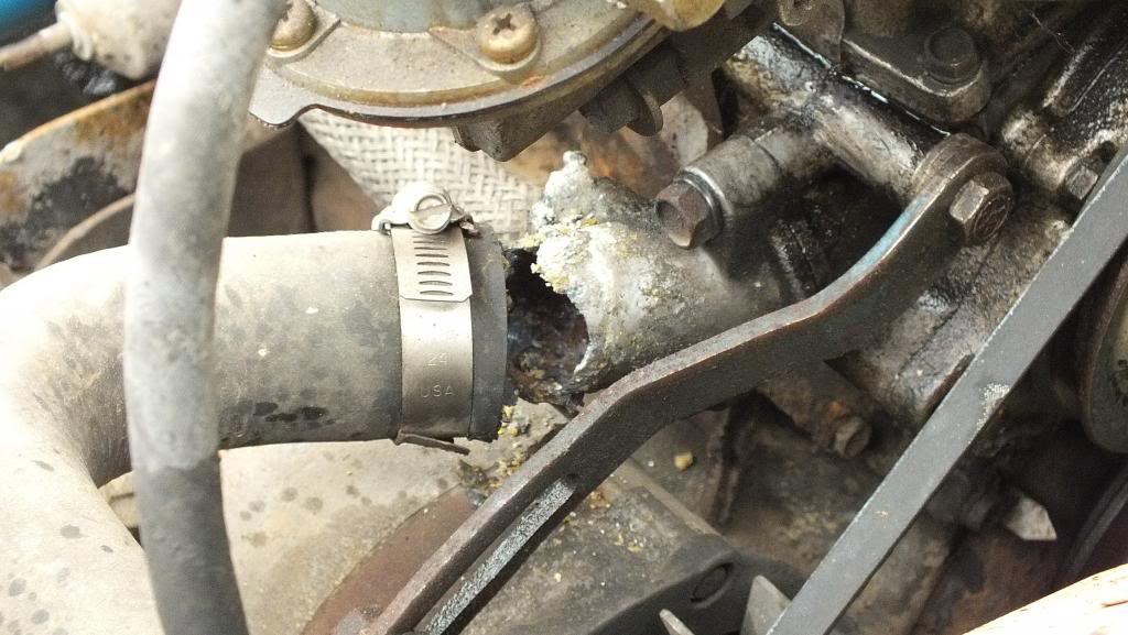

I made a very shocking discovery when i was pulling the hoses off. I had no idea that this was actually possible. This is probably a result of the P.O running straight water in the system.
Also removed some A/C components such as the compressor and condensor.
The old stanky radiator literally had six holes in it.

I think I'd flush the entire cooling system about 27 times before you foul up your new radiator with gunk sitting in the rest of the system. There's a flush plug on the driver's side of the block at the rear.
Mine looked nowhere near as bad as yours and I had to scale away a "rust stopper" that was sitting behind the plug to get the system to flush properly, but it was WORTH it.

corroded
metal rot, I had similar issues with the water outlet on the passenger side for the heater, metal was so thin you could crush it like a pop can. Nice new radiator, like Laslo says I'd flush the system real good, but I bet you already had that planned.

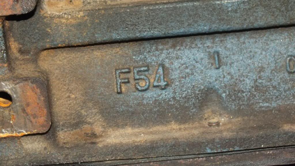

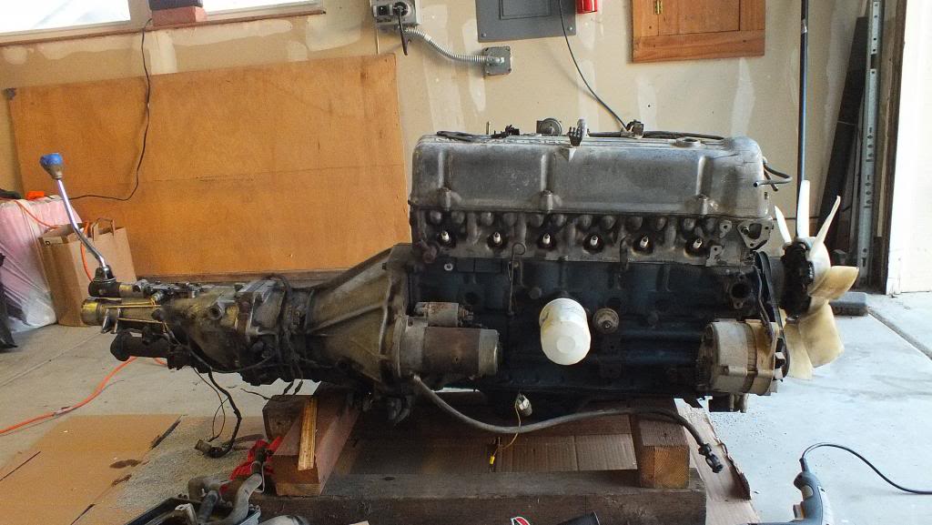

Based upon all of the given factors of this engine, I decided just to get an entire whole new engine. I mean i could have gone through the steps to rebuild it, but who knows. Corrision would have probably eaten its way through the cylinder walls by then or worse (if possible).
This is what i bought.
It's an L28E, F54 block N47 head 9.7:1 Compression. Not sure if head is from a maxima or not, but there is a spray bar on the cam. Mileage is unknown, engine came out of a '75 280Z with 88K, but this is a mismatched engine so who knows. Came with a 4 SPD tranny which i will be selling.

killer rust
To bad you lost the motor, good move imho to just replace it, hard to tell what might be lurking inside. Upside, you have spare engine parts now. If I had a 2nd engine sitting around I would polish one of the valve covers ! Hard to do on the engine, and I need a spare so I can drive the car, since it's my DD now.

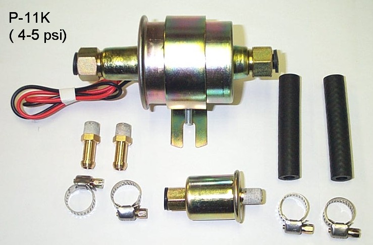

Due to this engine not having that vacuum port on the head for the stock pump, i am going to have to go electric.

This is what i bought. AND YES, THE MYTH HAS BEEN CONFIRMED! Nissan had installed factory accessory wiring to accomodate for something like this. In the radio compartment, taped to the major harness there is a T plug with two wires, GRN and BLK with a white stripe. Connect those two together (Preferable with a fuse in between) and you'll get power to wires by the tank that are also taped up, but to the fuel sender harness. Connect those wires to the electric pump. What all of this does is enable the pump to work automatically once the ignition is turned on. Now i just gotta figure out which fuel hose is the main hose to the carbs...
very cool, that is info that needs to be handy for everyone, nice job figuring that out ! Cheers !
The 75 280Z came with the N42 block and N42 head. Definitely from a
later model. A F54 block would designate from a 81 to 83 280ZX.
Agree. A complete different motor sounds like an easier way to go.
