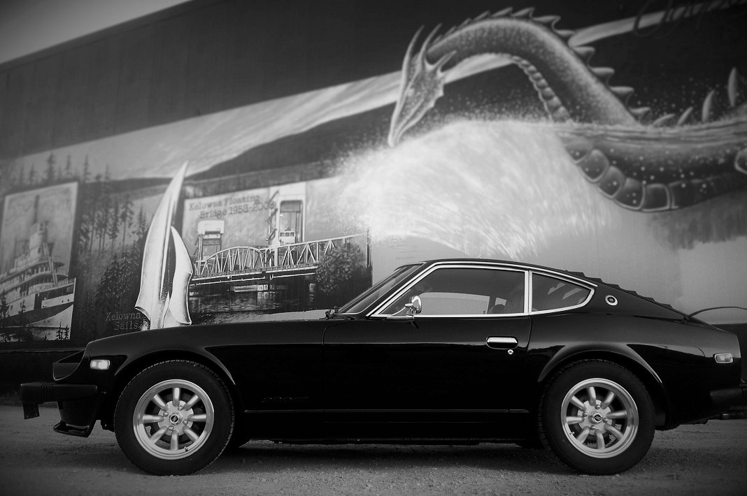

She is gorgeous!!1

Thanks for the compliment on the car it is a work in progress....as they all are. So here is what I did, I had a used battery out of a VW TDI, with lots of reserve. I then adjusted the timing within the distributor (advanced the retard timing via the plate in the distributor) and I am not having any cutouts now. I'm still concerned with the amp output, I didn't mention that I also ran the amp test with loads on with higher rpms, it would climb then level out around 17-19 amps. My dash meter is still around 16v and battery at about 14.5v. This could be normal output, but I can't find any specs. But I think the alternator is weak. As far as cutout at higher rpm, none.
Also Skully, I checked out your road trip pics, we just just did a 1300 mile trip to Portland ORg. It was a blast! The car is happiest at 80mph all day. Thanks for the input guys, I'll let you know what I find. Also I lived about 5 years in Stoon, some good memories...Bud's On Broadway!
