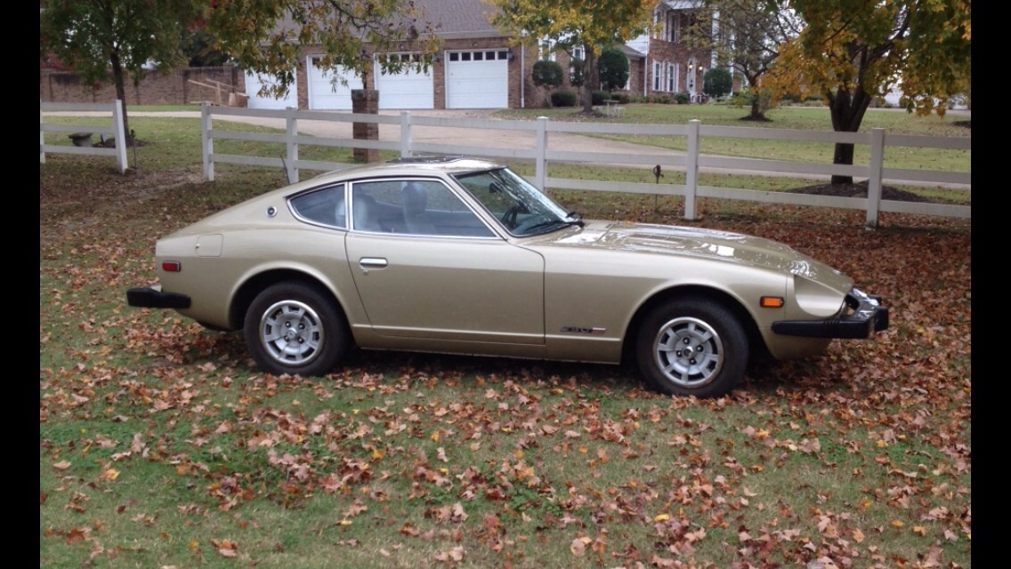

Here is a pic of it.
Attached Thumbnails Aftermarket rim question/what size tire?-image.jpg

280Z looks to be in very nice shape.
