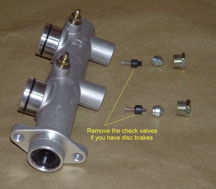

You can move the plastic reservoirs but that is moot.
My understanding is that the front and back cylinders have different valving in the bottom of the master (where the big nuts are). You can swap these around too.
OR you can bend your brake lines to match F and R accordingly.
Old Apr 15, 2013 | 05:40 AM
blue's Avatar
Joined: May 2006
Posts: 16
From: NJ
Old Apr 15, 2013 | 06:05 AM

I didn't know about removing the check valves for disk brakes.
