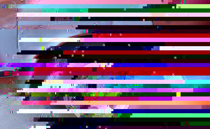

Yesterday I took my passenger rear quarter to bare metal. Some a$$ had fit a patch panel and used about 3 to 5 pounds of Bondo. I knew I had some filler in this area but this was sick! They fit the patch high in the rear and low in the front and used Bondo to "hide" the transitions. The door gap looks unnatural. I think they fit the front of the patch with the door open and later discovered their mistake. Instead of cutting the patch loose and re-welding...Bondo to the rescue! I'd like to find a quarter panel like one of these listed on eBay. Unfortunately both of these are driver's side.
