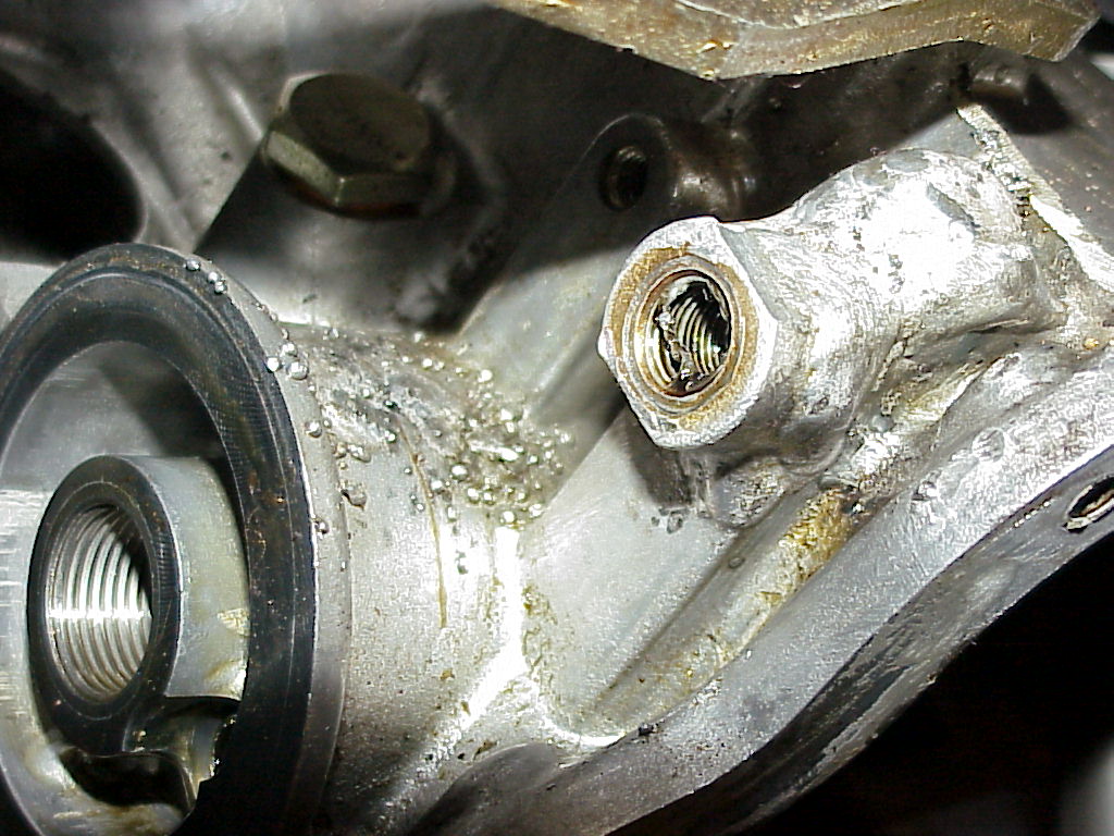

Ok, got the pix. Ugly. Still waiting on the possible causes. If anyone has a picture of a "healthy" oil pan connection, please post.

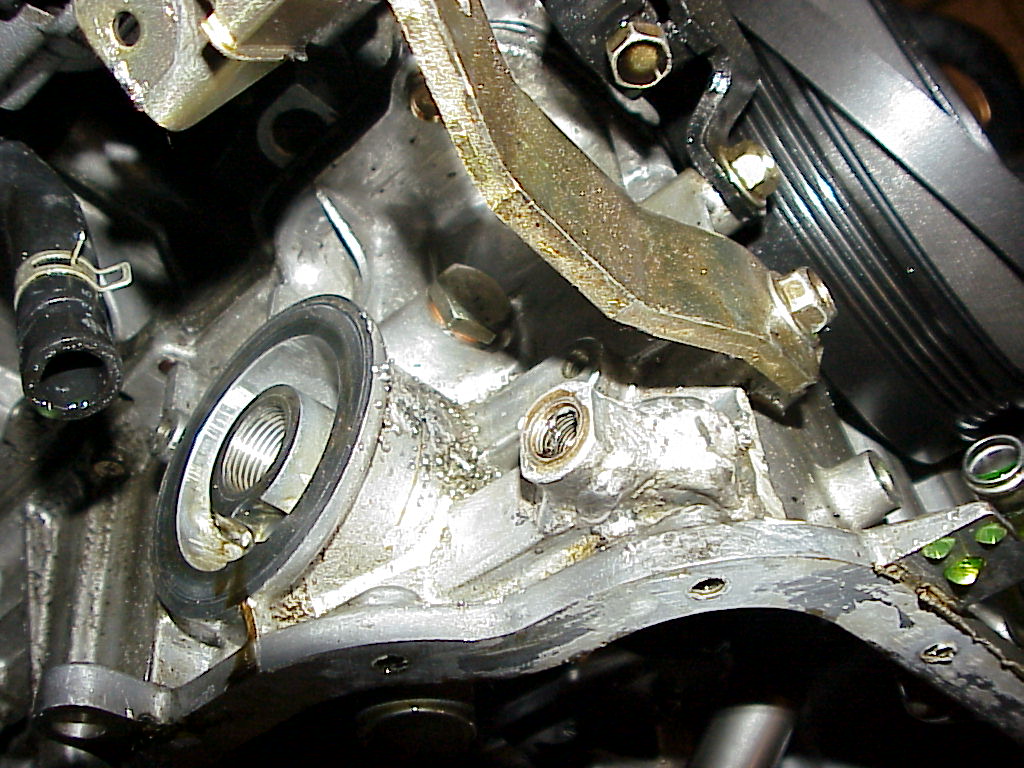

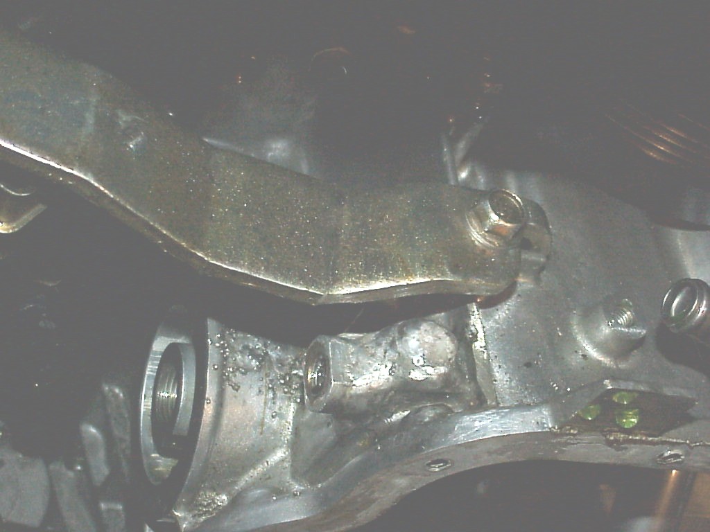

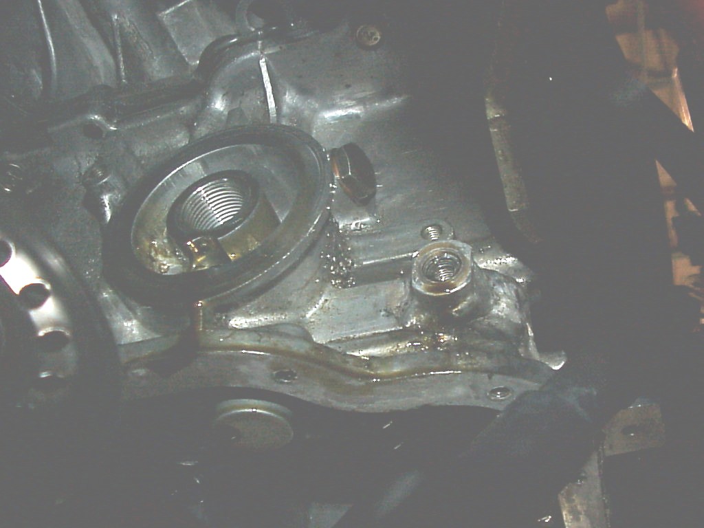

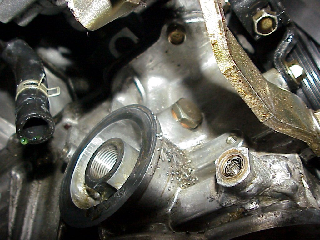

more............ they must have really hit that thing with some force to require it to be welded back in place. note the metal beads from the sloppy weld job - can't believe i didn't notice it before.

The splatter is because they didn't use any shielding gas when the welded it.

turns out the threading was cracked as they tried to force in the T-bar that is used to divert oil between the pressure sensor and the turbo. they then attempted to rethread the pan and reinforced it with welding. the original install shop remembered doing it, and he agreed to pay for the repair (at least most of it). i wish he'd told me, though. so a new upper pil pan is going in, hopefully that will be the end of my saga.
