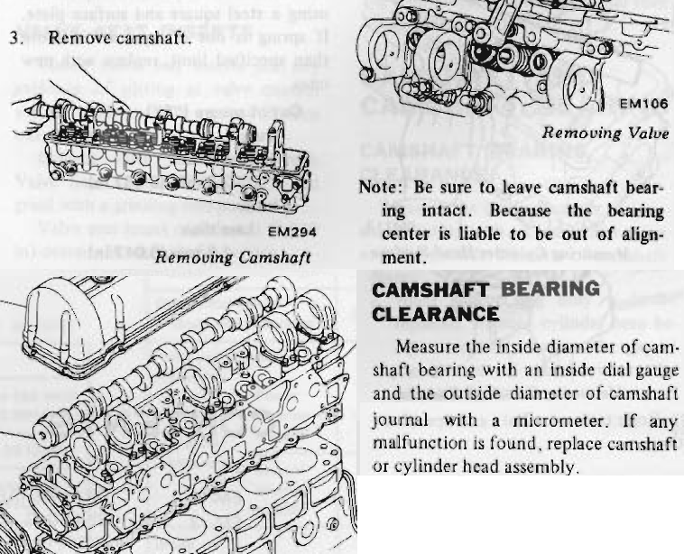

Uh ya.... but their not suposto be taken off.... and if you do you have to realign them to keep from wearing down the camshaft and bearings.

yes they are, what do you think the dowel pins and bolts are for? thats like saying you arent supposed to remove your cylinder head or bearing caps.

Ok then, why doesn't the FSM have anything about it then?

See look

lol, that thing was written like 30 years ago when people could barely change their own tires.

That thing was also made by the people that built the car.

its standard to pull them when working on heads every time Paul (BRAAP) dose a head he strips its completely,
even the valve guides come out. just keep them in the same order.

Ok what Im trying to say is, you CAN take them off, but your not suposto take them off.

why? realigning them isnt hard or even a problem, the only thing going through them is oil and when you take them off for a head rebuild they are realigned anyway.

theres nothing wrong with taking them off, just like anything else you gotta put them back right.
