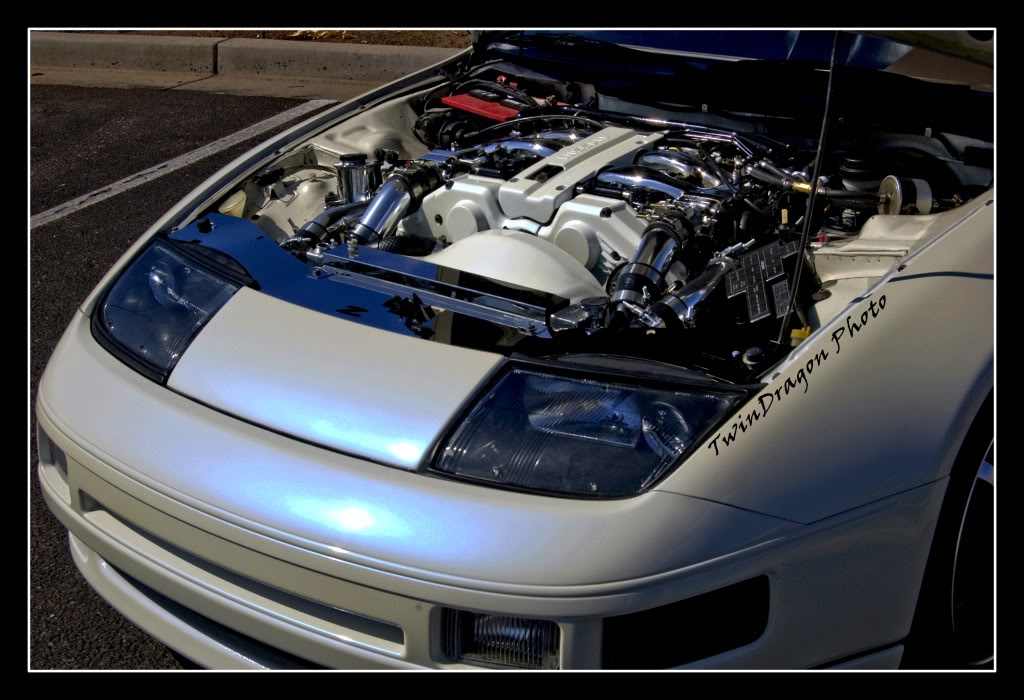

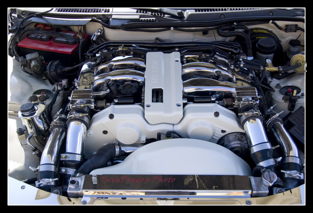

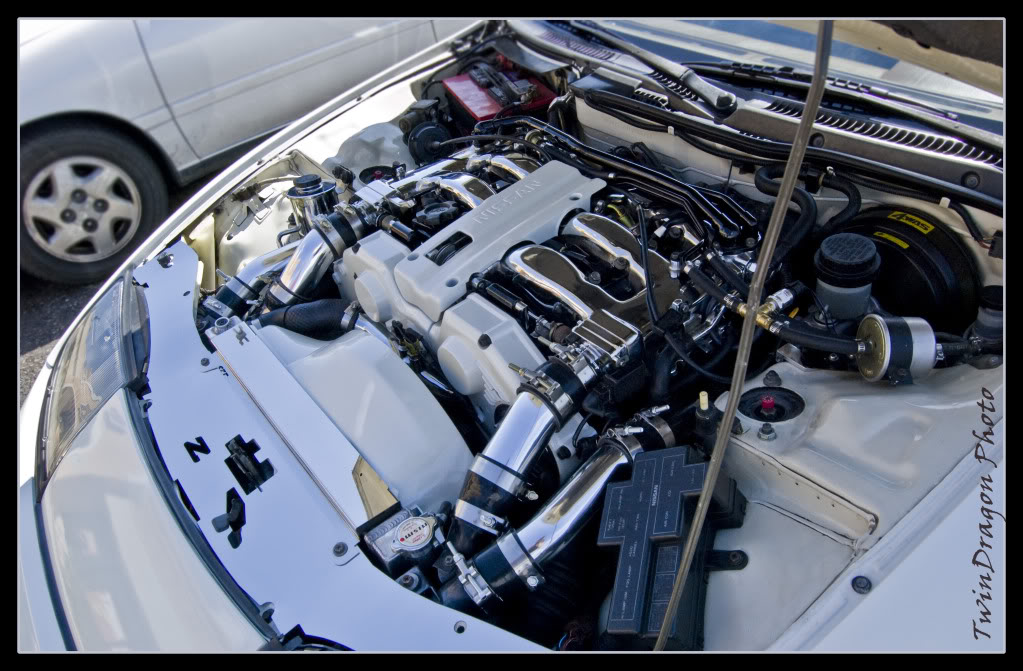

6 Attachment(s)
Those gaskets are correct. I just did my engine and mine where the same. Yours are flat (old ones) because of the time they have been on there and heated and squashed etc... The ones you have are the correct ones. FYI I have zero leaks after my install.
Here are engine pics of what i did:
Was:
Attachment 21029
Attachment 21030
Is:
Attachment 21031
Attachment 21032
Attachment 21033
Attachment 21034
