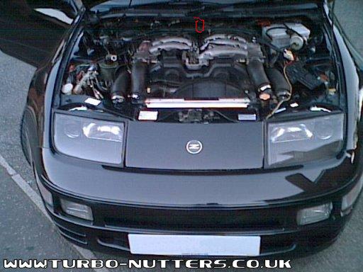

This isnt my car but the area in red is about where its at

there's 3-4 connectors in that area, think you could get a closer pic.
I dunno maybe of YOUR CAR.

its probably the knock sensor, and if its disconnected look for a little 1megaohm resistor ghetto rigged into there somehwere, if you find one then you most likely have a bad knock sensor and someone bypassed it<BR><BR>
btw is this what your talking about?<BR>
http://www.angelfire.com/geek/vg30de...tSenRel01.html (several pics of detonation sensor location)

I think that may be it. everything is still connected but the wires rubber sheath is coming off.
