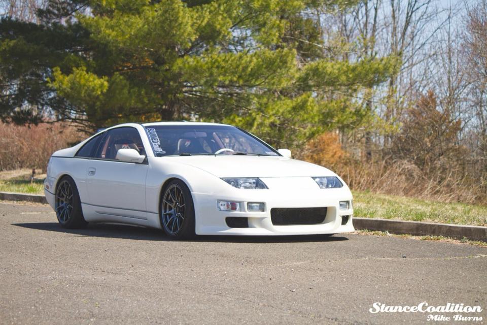

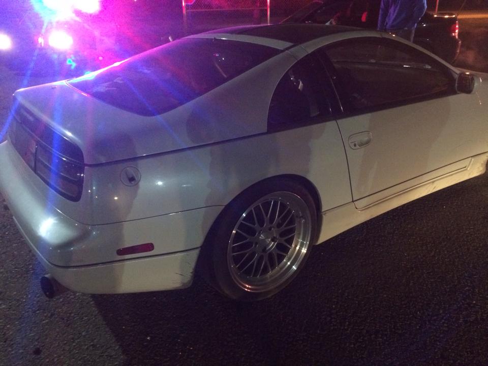

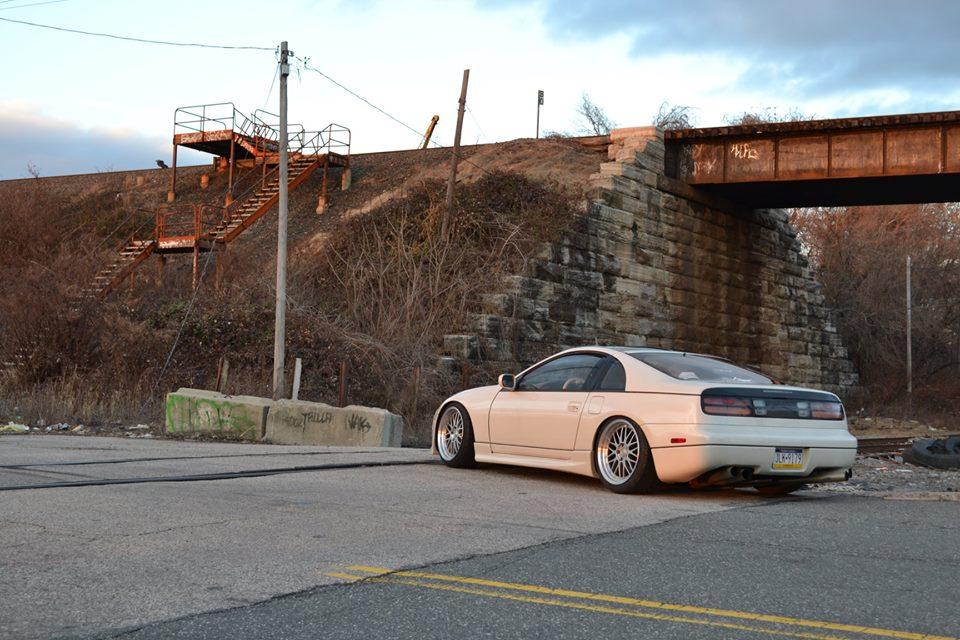

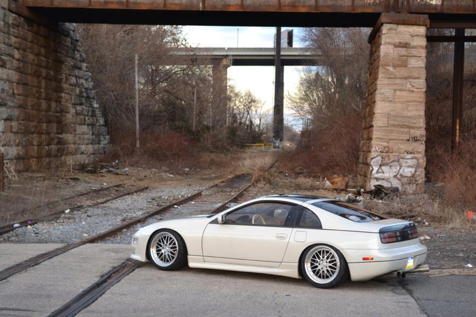

Well, I recently picked up a N/A 1990 z32 that's absolutely gorgeous. Slightly modified, but to my liking. Picked it up with a bit over 96,000 miles and paperwork for over $4,000 in transmission and engine cleanup. Almost all the seals, belt, etc. were replaced. Unfortunately, the vacuum lines weren't.

I added some pictures to original post.
