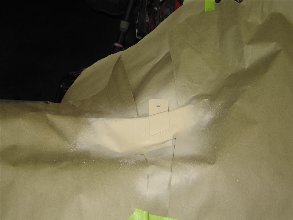

Direct bolt on is not really the right question, but the only thing that is not present on the N/A chassis that needs to be welded into place are the tabs on the upper radiator support for the inter-cooler piping...
and the tabs on the lower radiator support to hold the TT radiator...
Everything else will bolt right on.
