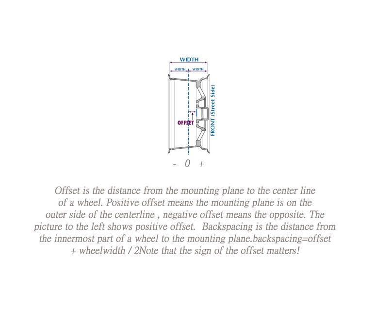

This helps people from time to time as well for understanding wheels and offsets.
