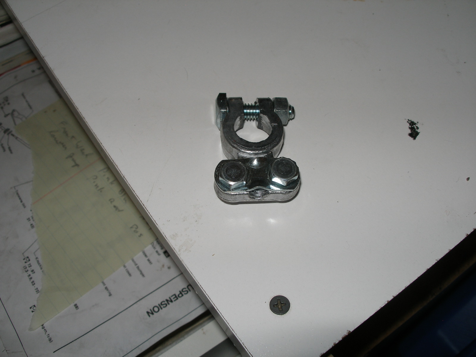

get your battery load tested and the charging system also. free most battery shops. are your battery cables in excellent shape. terminals tight with no corrosion - both ends. is the ground strap grounded to the frame before it goes to the starter. grounding through the starter is not a reliable method. IF your battery cables have those one size fit all clamp type connectors get rid of them get some real battery cables those jackleg fitalls that lazy people use are problem waiting to happen. pic of terminal i'm talking about.

yeah terminals and everything are great. ill got get the battery tested and alternator. thanks
