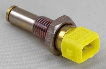

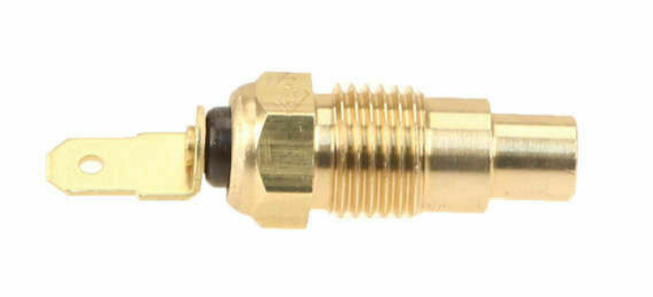

According to the Z Store, the CHTS 'located in the front of the driver's side cylinder head' and 'This sensor was incorrectly listed as being located on the passenger side head; while its function of sending a signal to the ECU was correct. This was based on decades old data that was unfortunately never reviewed or updated. Upon recent review, it was discovered that it was also a duplicated part number (11-3451).'
Originally Posted by Qaanaaq-Liaaq
The coolant temperature sensor sends a signal...to the dashboard coolant temperature gauge. The cts does not send its signal to the ecu. It’s located on the passenger side of the intake manifold.
It sounds then (to me anyways) that I might just need both sensors as the coolant temp display never gets anywhere near centre and the radiator fan is always running. My car has analog display rather than the digital option. So, I should be looking for these guys:
