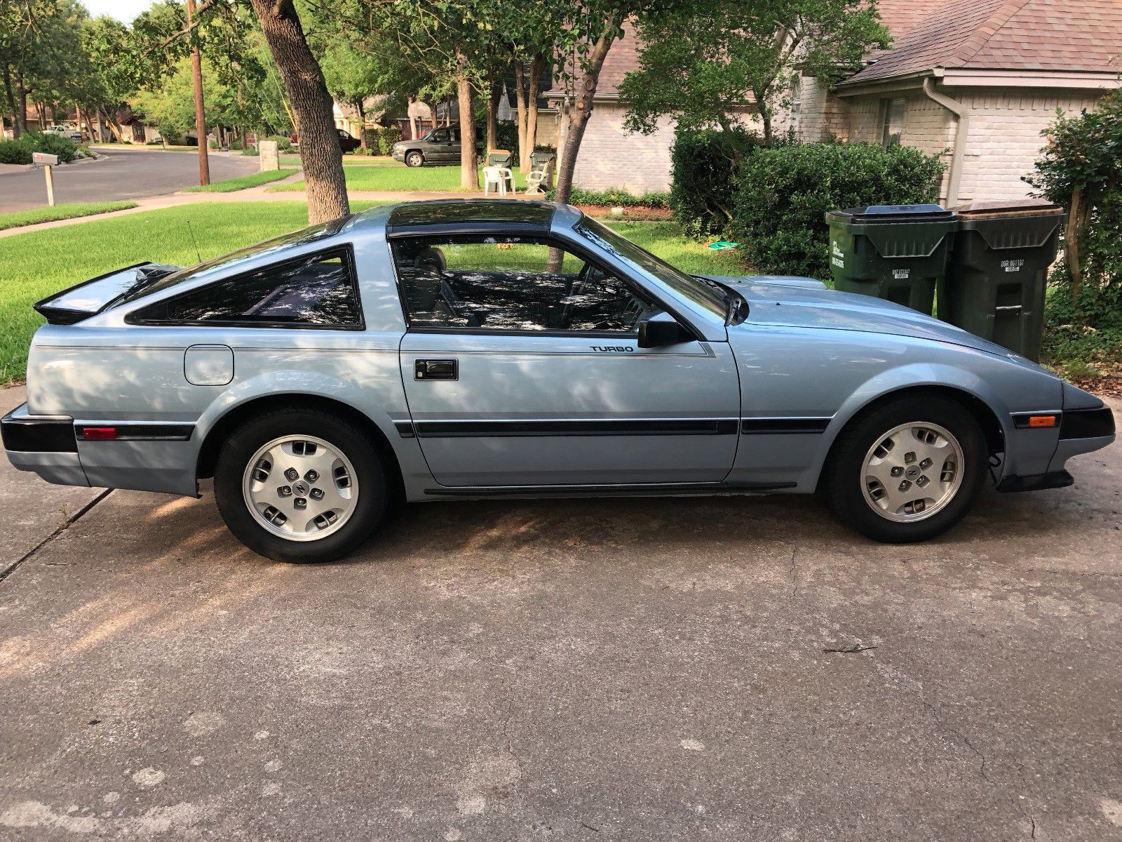

BTW, your 84T or 85T looks like it is in great shape. Nice!

Thanks man it is pristine on the inside, and I do love the Lady. Thanks for the info.

If that is yours, Immaculate!!
