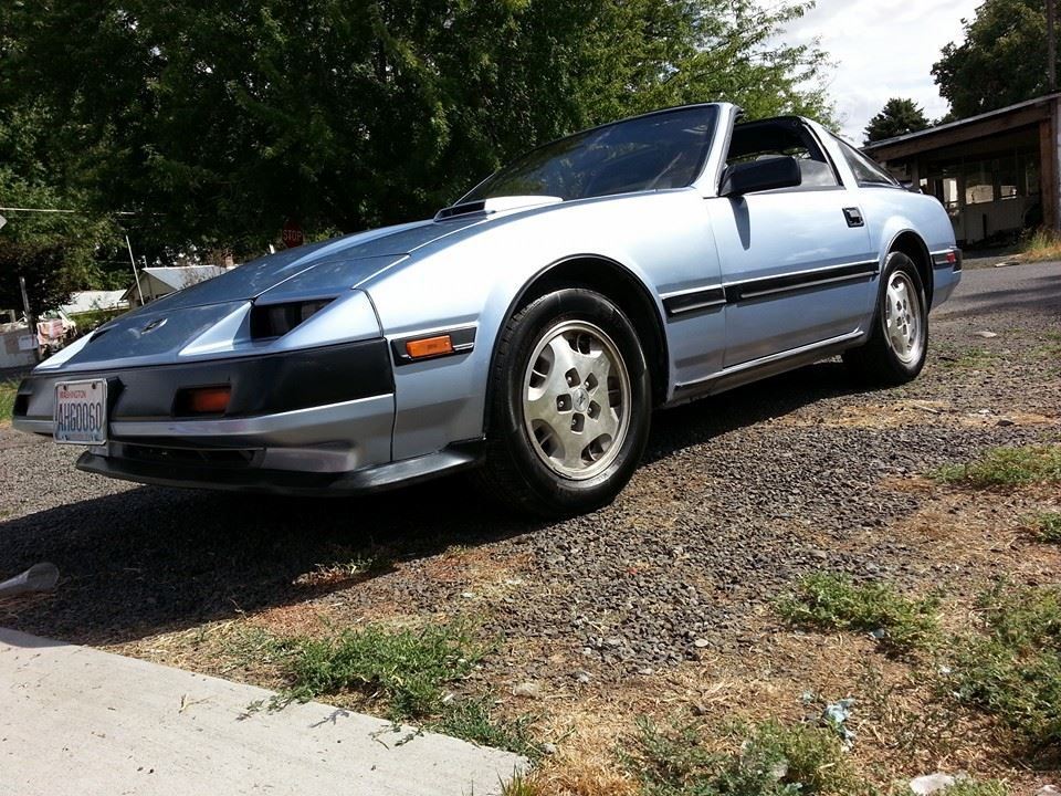

Hello everyone,
New to forum, but not new to the Z31, i have owned 3 over the last 20+ years.
ive owned my current Z for about 5 years now, NOT a daily driver. Only driven on nice days in the summer, around 80k original miles.
Sadly it has not been driven for sometime.
