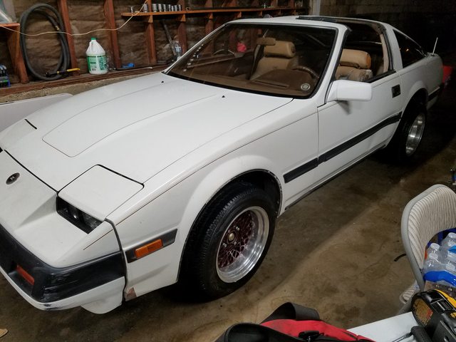

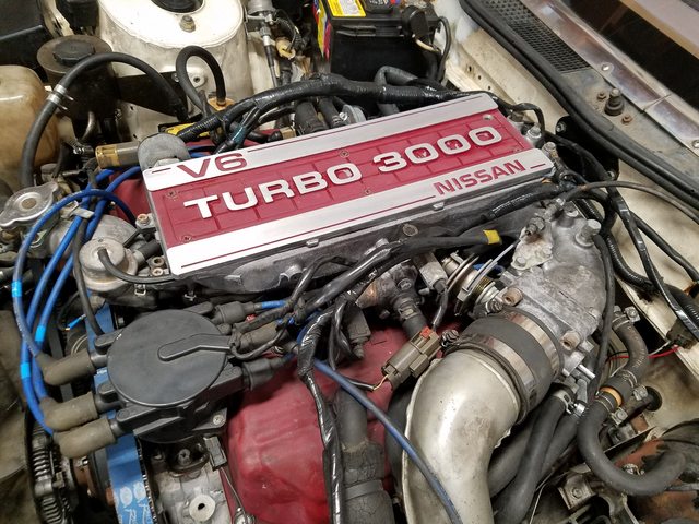

Good afternoon everyone,
I recently purchased my 31st car (first Nissan) and I couldn't be happier. It is a 1984 Turbo Z31 with a manual transmission & 140,000 miles. It looks like the previous owner swapped a manual transmission in it because the wire looming doesn't appear to be stock.

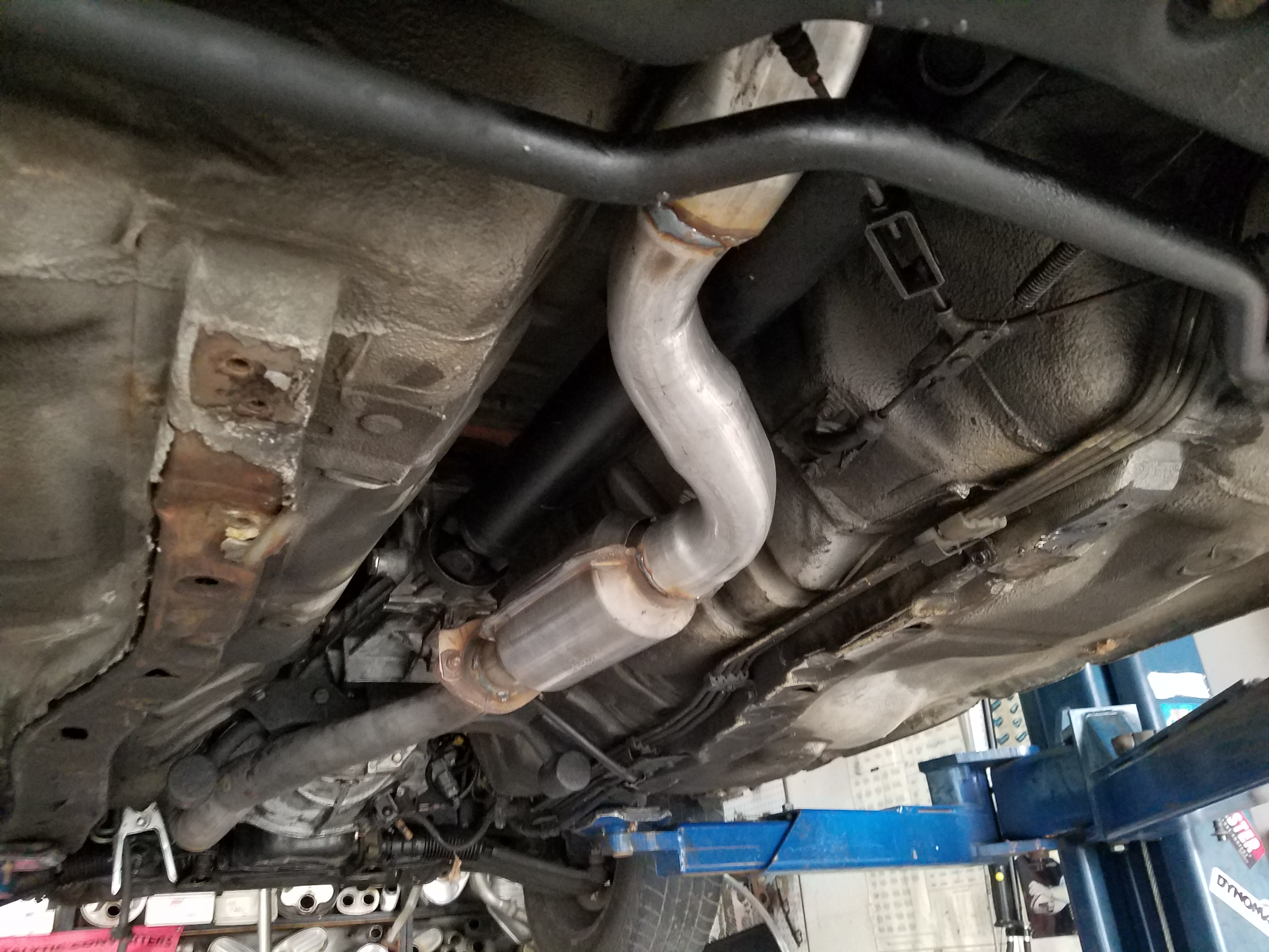

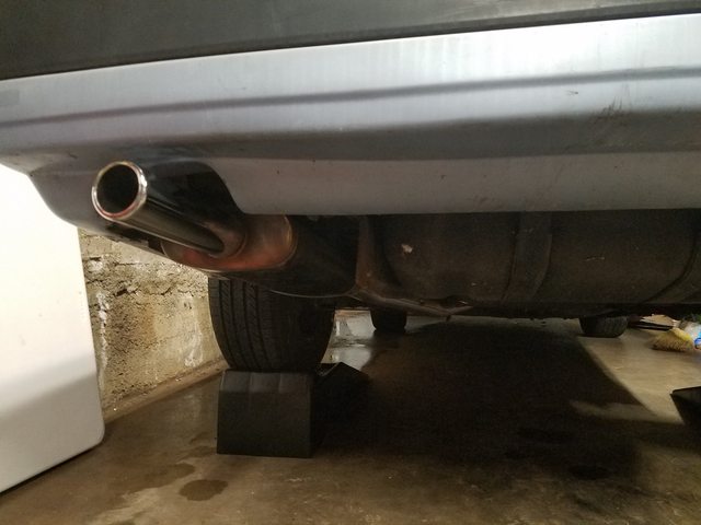

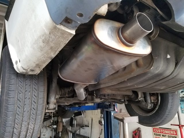

It came with no exhaust after the downpipe so I just had a high flow cat and magnaflow muffler welded up yesterday. Before having it installed, the thing sounded like a cam'd American V8.
I've ran into a few problems so far:
The idle sucks, it dies frequently unless i keep the idle up until it is warm. Once it is warm, the idle still bounces but it doesn't die.
The rear end clunks like crazy, I think it is the diff mount but when I looked at it, the mount didn't appear completely busted.
The starter grinds 50% of the time when starting... maybe an adjustment is needed?
Interior is disgusting, I'm debating just gutting it since this is solely a project car

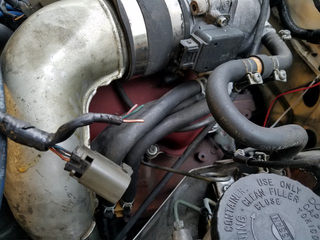

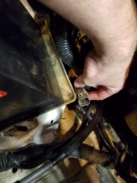

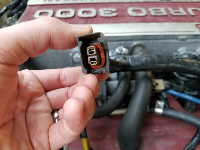

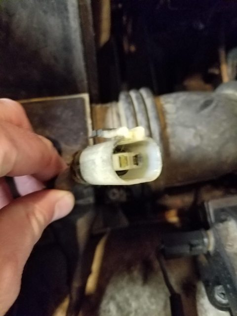

There are a ton electrical connectors not plugged into anything and the TPS is not wired up nor is the connector anywhere to be found!
Any input, questions, concerns are welcome.

TPS, loose wires and clip nearby
Passenger side by firewall loose connector

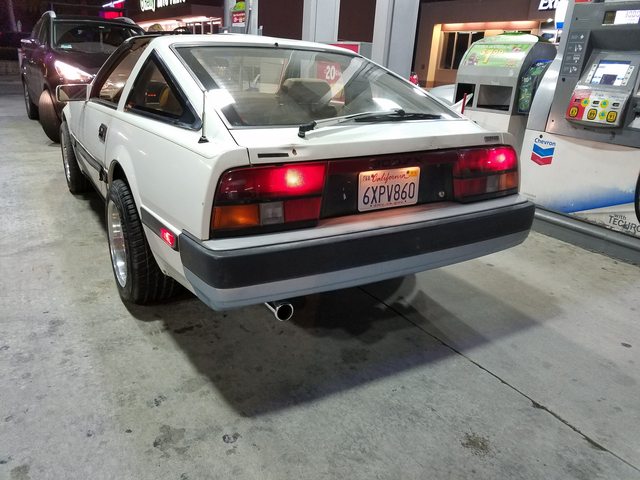

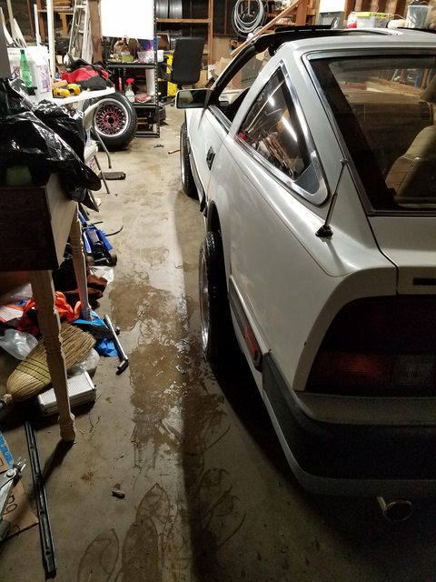

New custom exhaust while it was being welded
Finished

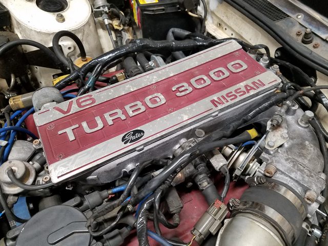

I got disgusted by the clear coat discoloration so I brush sanded the plenum cover... pictures don't do justice.
Before:
After:

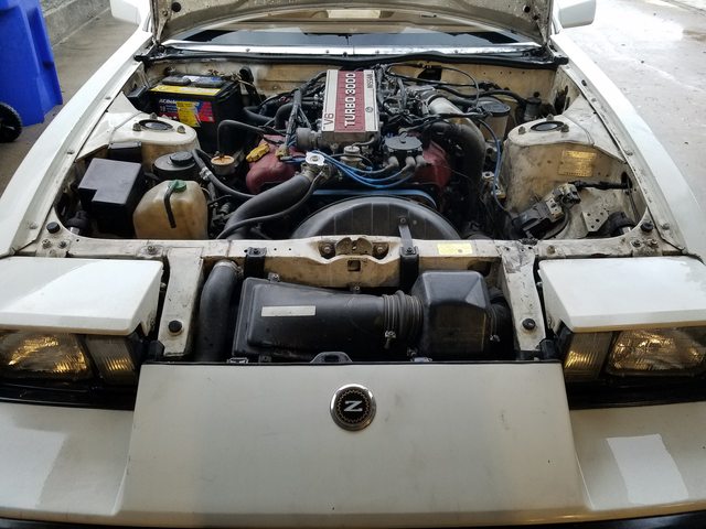

Looks like a N/A 84- wheels ,hood
That s the problem ,it got a turbo motor with out the turbo wiring
check the #s on the F I ECU
​​​​​​​to see if it is turbo
Old Feb 19, 2017 | 06:49 PM
electricalbox's Avatar
Joined: Feb 2017
Posts: 9
I agree with you, I believe it was an NA that got a vg30et and manual trans swapped (or at least the trans).
The ECU has "87 turbo" written on it in paint, almost as if it came from an aftermarket supplier.

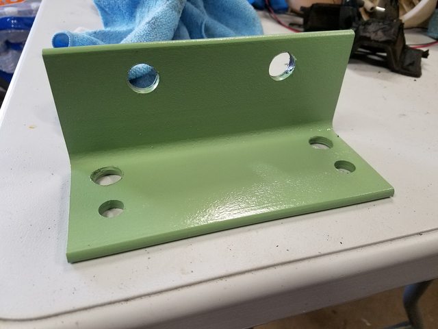

I pulled and found that the differential mount was trashed causing a lot of vibration. I decided to make a solid mount utilizing some 3"x3"x8" angled steel (1/4" thick). The thickness is easily overkill, but it was readily available.
Old mount vs new steel
DVqRqMbl.jpg?1
Drilled out using the old mount as a template. The holes bolting to the frame use 1/2" bit while the two to the diff use 5/8". I opened up two of the frame bolt holes to allow for easier installation. The piece was painted Pistachio green because once again, it was readily available in the garage.

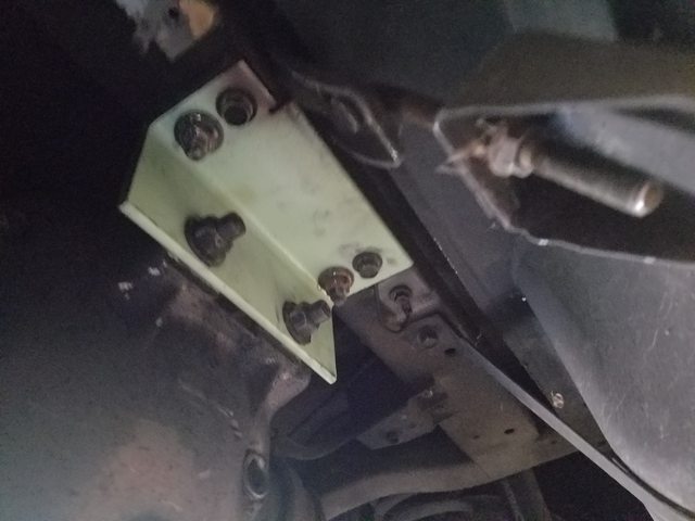

All bolted up and dirty already:
Initial impressions made the rear much tighter and the jolting calmed down. Of course with this being a solid mount, the shakes and transfers now put more stress on the other mounts so I'll be making solid mounts for the engine and subframe soon. I'm not worried about the vibrations because this is merely a project car.

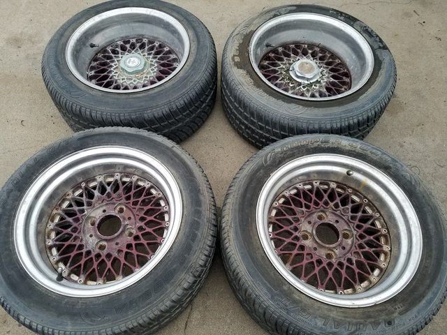

Found some Hayashi Racing HRE Techno R wheels locally today. Great deal on them, but unfortunately they are in horrible cosmetic condition and are slightly too wide. They appear to be 15x8.5 front and 15x9 rear... offset appears to be 0 or even negative.
I'm on the fence of flaring the car or when I refinish the wheels moving the fronts to the rear and re-barreling the rear.
Onto more pictures:
While they had two caps the wheels are severely weathered. Caps are trash...
Wide and stupid on old stock suspension:

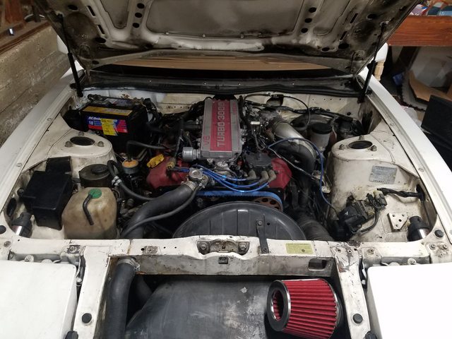

Lame update:
Hood struts, spark plugs, and a leftover filter was installed after I opened up the stock box and found no filter.
