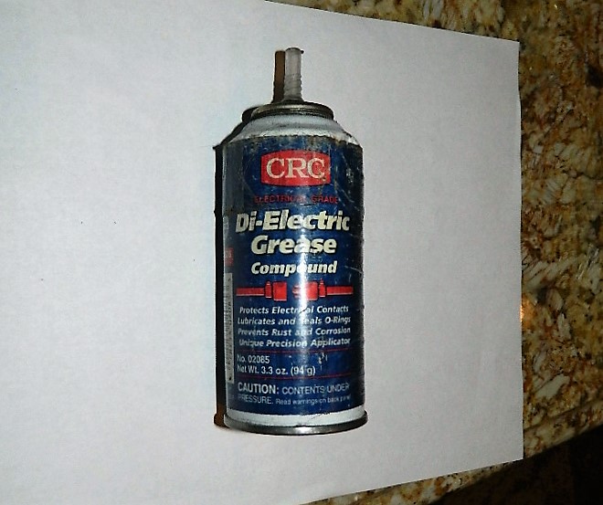

Here are a few pictures of some tools to have; A battery post and cable clamp cleaner, Dielectric grease, 2 types of electrical meters. either one will work for you. Digital is on the left and an analog is on the right. You can purchase a base model or a very expensive one to check the DC voltage of the battery and whether you have open or closed circuits (These 2 tests are the most popular uses for a beginner).

better off with a spray on corrosion inhibitor. Dialectric grease is an insulation medium meant to be used on the outside of insulators. Why does everyone insist on using it to insulate things that are meant to conduct electricity. like inside the plug on a maf connection and the like. look up the meaning of dielectric. https://en.wikipedia.org/wiki/Silicone_grease

"It can be applied to the actual contact as well, because the contact pressure is sufficient to penetrate the grease film. Doing so on such high pressure contact surfaces between different metals has the advantage of sealing the contact area against electrolytes that might cause rapid deterioration from galvanic corrosion"
Exactly what the cable connectors and the lead posts on a battery see and a "little dielectric grease", not an over abundance, can help!

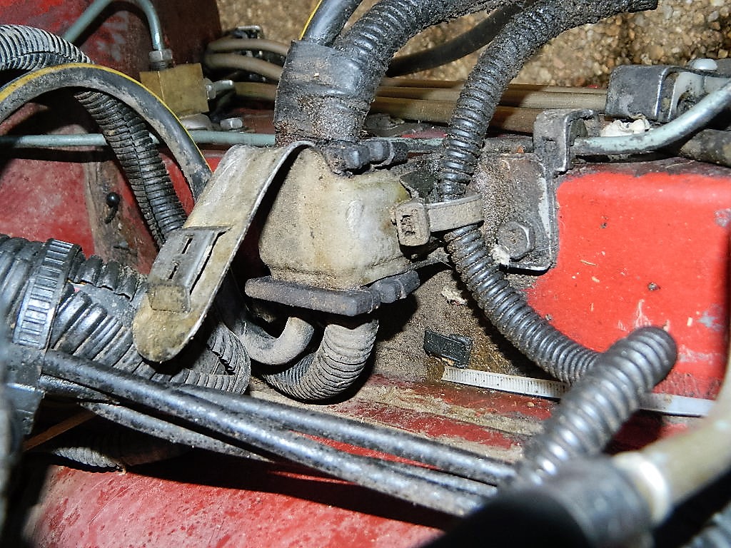

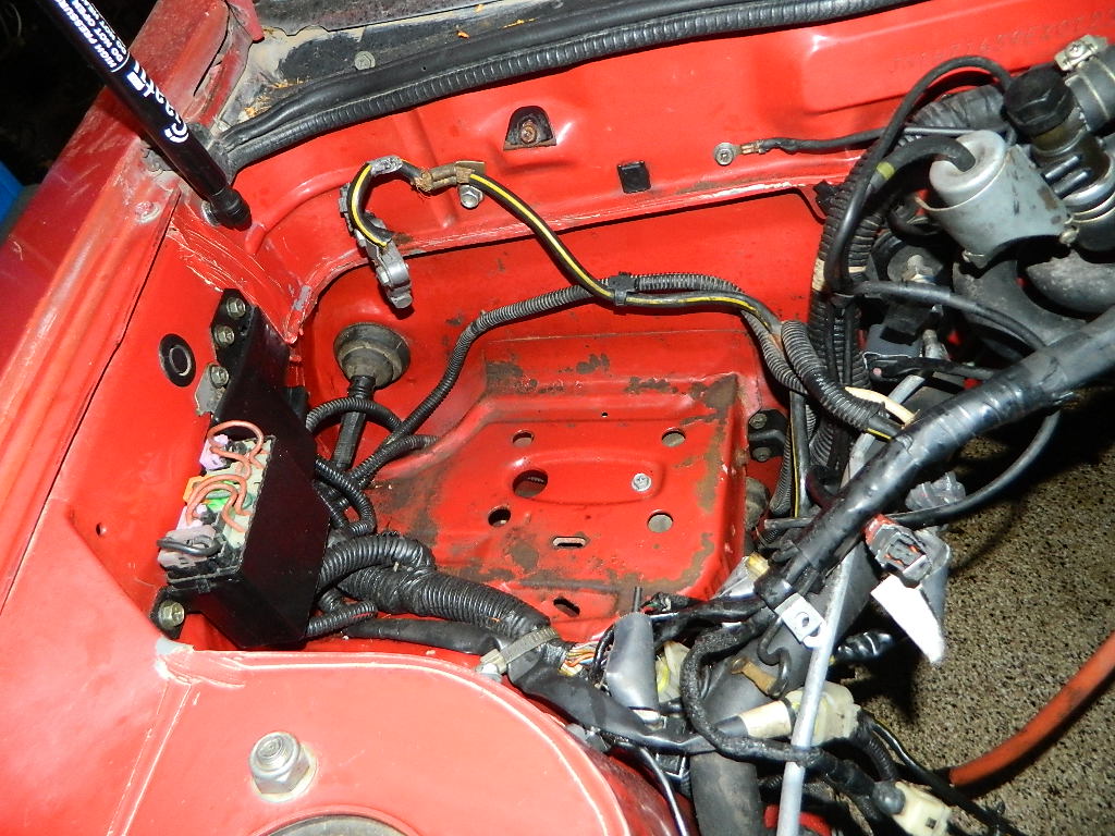

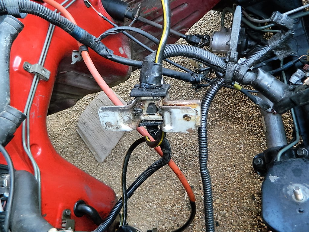

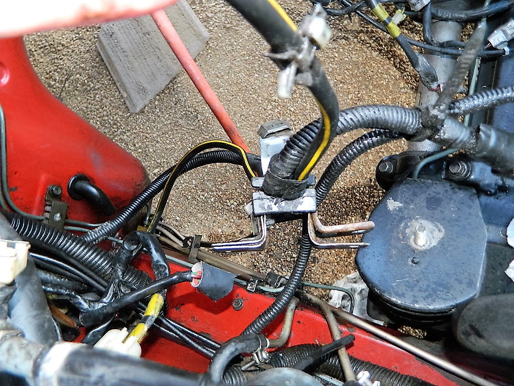

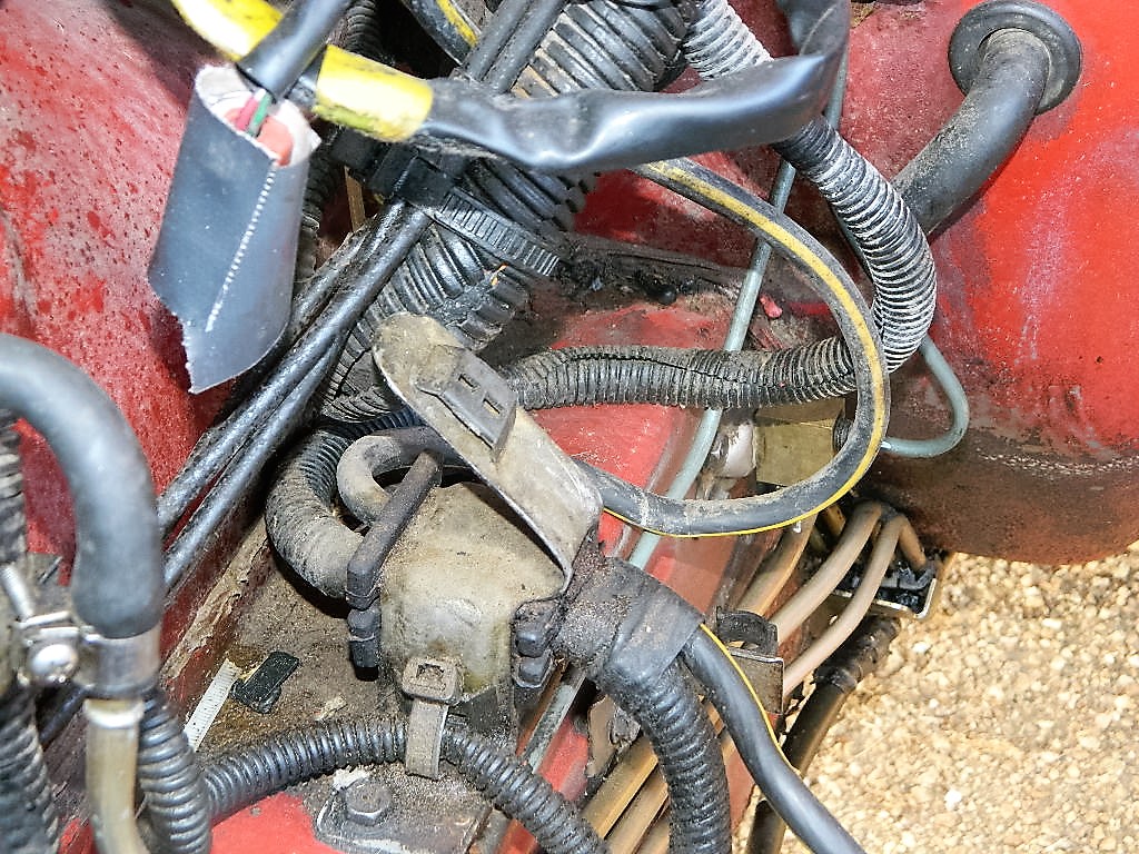

The following attached pictures and Starter electrical schematic is for a 1984 300ZX. I believe it is the same for a 1985, but you will need to get a copy from the Factory Service Manual to confirm. As you will see on the electrical schematic, it shows both the manual transmission and the automatic. In the right corner of each section there is a "LEGEND" that gives which wires to follow depending on if you have: (T) With Turbocharger models, (NT) Without turbocharger models, (TH) With theft warning system), and (THL) Without theft warning system. From this you can also understand why it is so important to get a FSM and to let others know on the form, exactly what options you have on your car (For future reference). There really isn't much in the starter system. The negative cable attaches to the battery, then, as the picture shows on my car, a flange on that wire bolts to the firewall, then the wire goes down to a junction box, and ends up being attached to the anchor bolt, under its head where it bolts through the bell housing. This grounds the starter.
There is a second wire that goes into that same junction box, it is a power wire, from the + terminal of the battery, that goes down to the "magnetic switch assembly" (solenoid), that is attached to the top of the starter. This wire goes to the top bolt on the solenoid. The wire coming out of the starter goes to the bottom bolt on the solenoid and there is a Spade connector with a yellow wire that goes to the 3rd connection. As you will see on the condition of all wires, on my car they were extremely dirty and corroded. They were all taken off and cleaned, as I am restoring this car for my daughter and Son-in-Law. Somewhere there is a short in the wiring.
I would suggest first, that you download a FSM and second, check all the wiring connections for loose bolts and clean them up. The one on the firewall, and those going to the bolt on the bell housing and the starter Solenoid as shown in the pictures. This would be "looking for the obvious" than starting with the 'Harder" things. Let us know what you find out..
Thanks, Bob

This afternoon I took apart what I mistakenly called the "junction box". It is actually an insulated bracket to hold the positive and negative wires rigidly against the frame rail. The large rubber piece is to insulate the 2 wires from coming into contact with each other. It might be possible that one of the wires has had the insulation rub through and is causing a short to ground. You might want to check this out.

Bob, where does the giant ground clip showing in pic 5 by the steering rack go? I will be eternally grateful if you can help.
