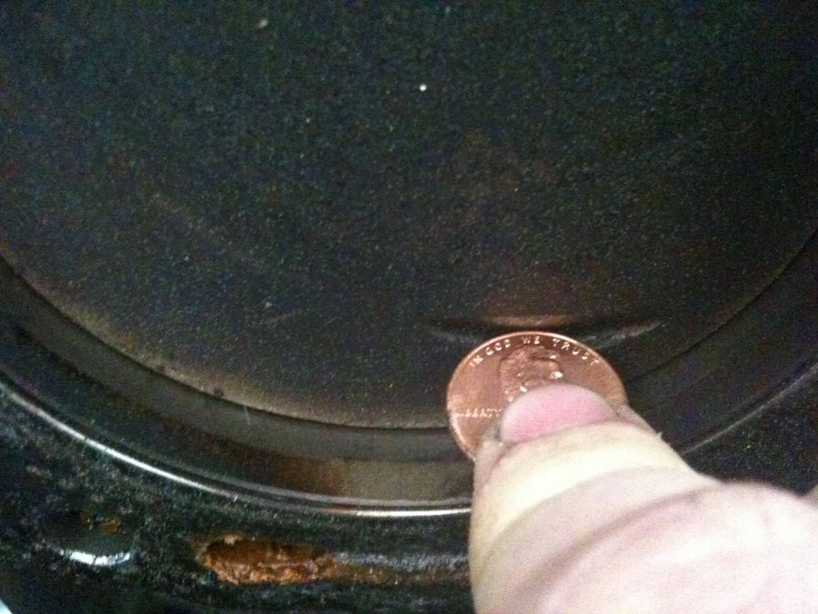

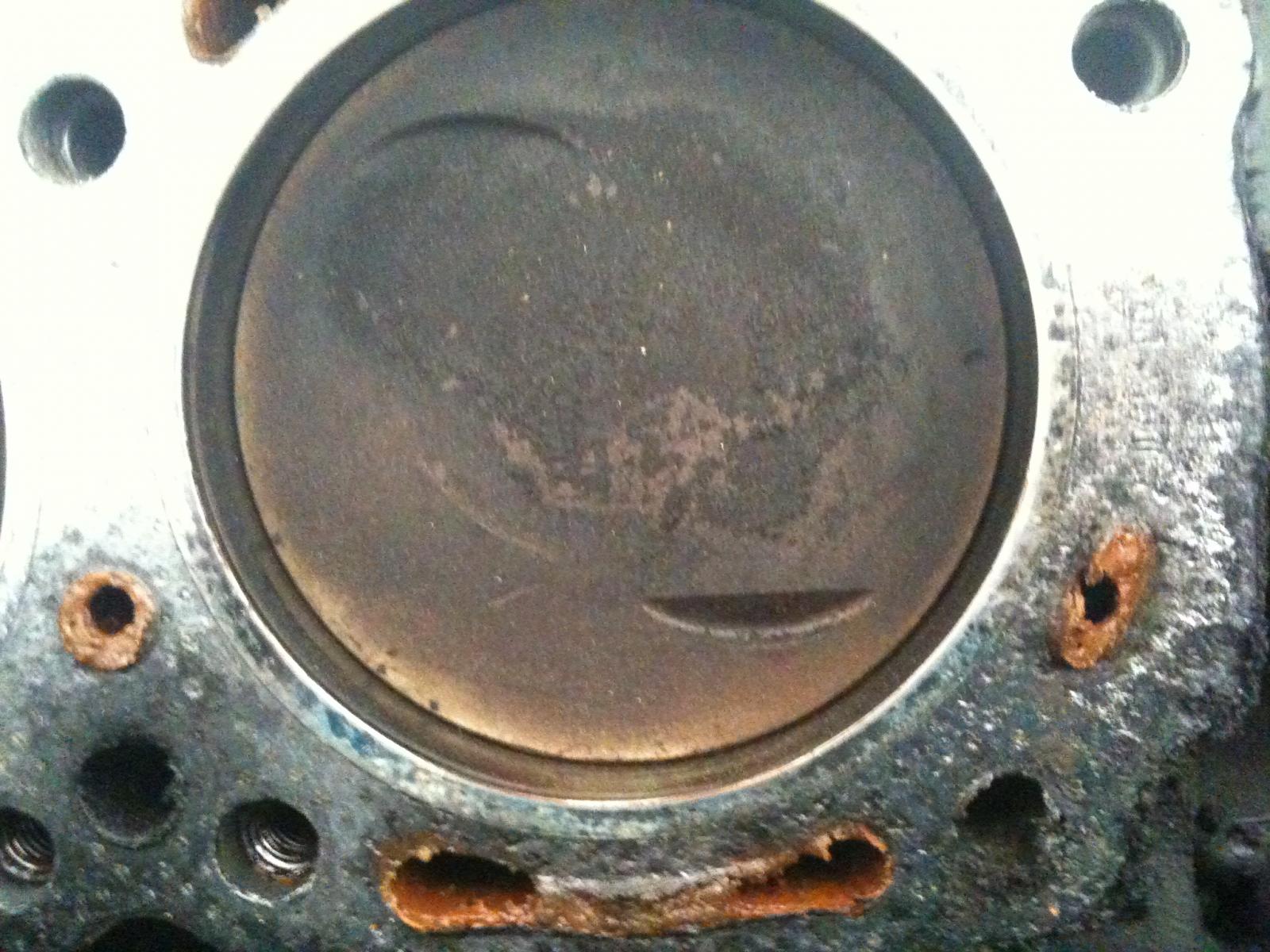

Here are the pictures, I did one with a penny to help show how deep it is and all the pistons seem to have identical markings. Let me know what you think

Im trying not laugh right now. but thats how's the pistons are supposed to be. Nothing to worry abt. They are there to give the valves some wiggle room or something like that.

This is why you should have more information in your posts. If we had known you have an NA, we could have told you before you posted pictures. You didn't find it the least bit odd that all 6 pistons have the same reliefs cut in them in exactly the same manner?

Yes. The turbo pistons are dished and do not contain relief cuts. It's the reason they are 7.8:1 or 8.3:1 compression vs the NA 9.0:1 compression.
Hey. You're learning.
