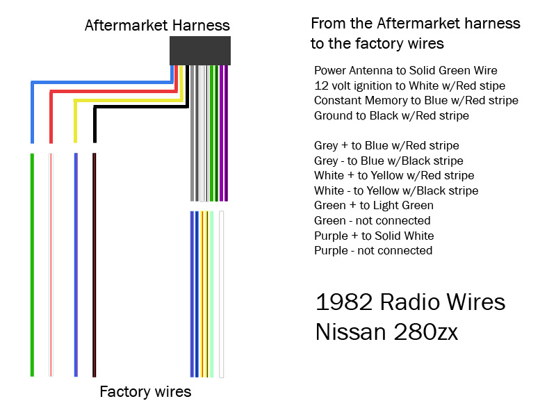

Alright guy's, i did nto feel like starting another thread for something small. and it's pissin me off. I can't find the freakin hot wire for the radio. What is the color/strip color of the wire? and what are the two wires that run from the talkin ladie box to radio for the sound of the box? And the box has not yet turned back on since that night.
Old May 2, 2006 | 10:25 AM
thxone's Avatar
Joined: Apr 2006
Posts: 2,827
From: Concord, NC
Wire colors
I could not find the thread I originaly put this in but here it is.
