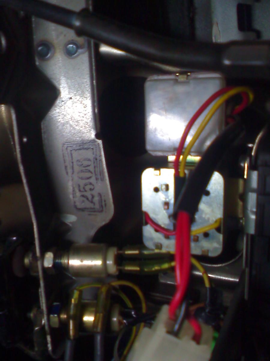

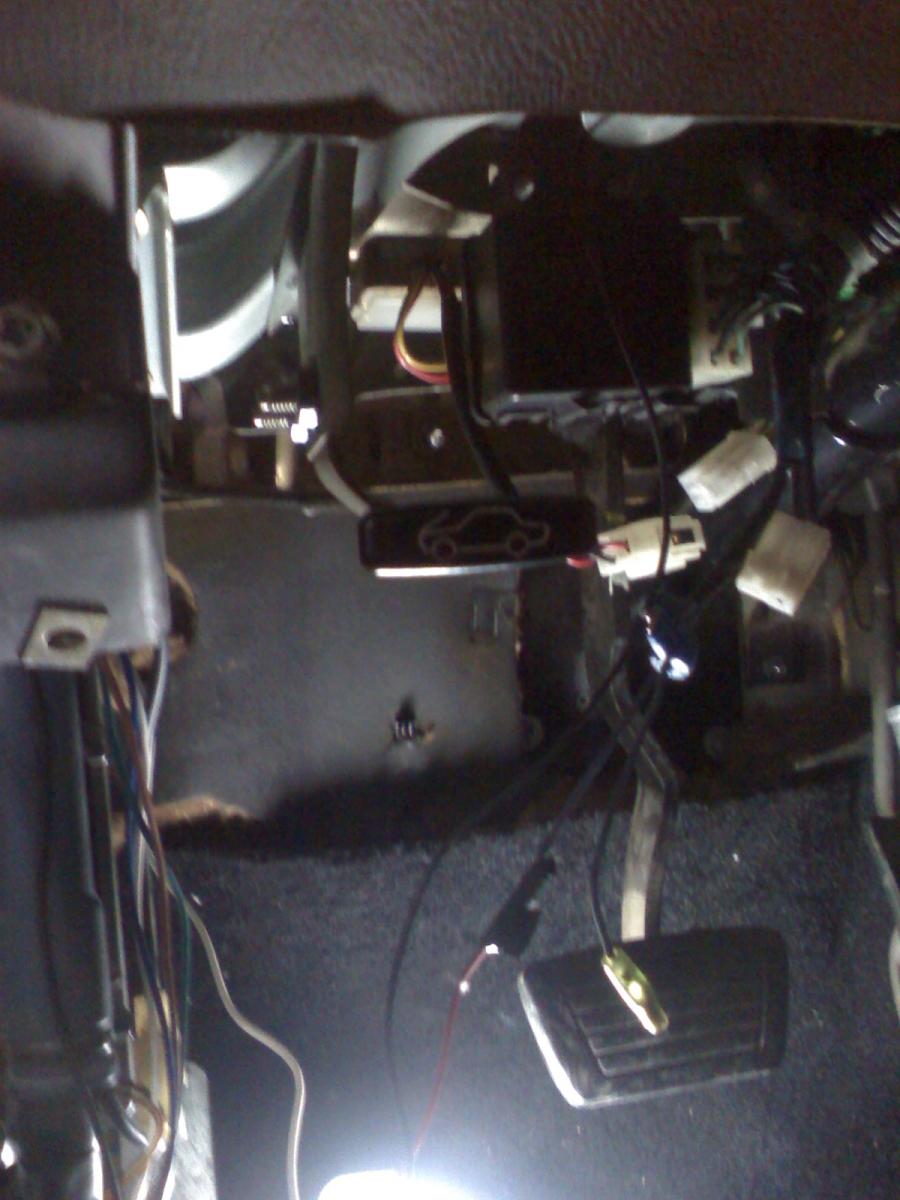

its a small white box that was unplugged and i dont like having random wires unplugged so i plugged it in and it started clicking and wouildnt stop im lost and decided to inquire among individuals who now more about my car than me lol

Looks like the door chime to me.

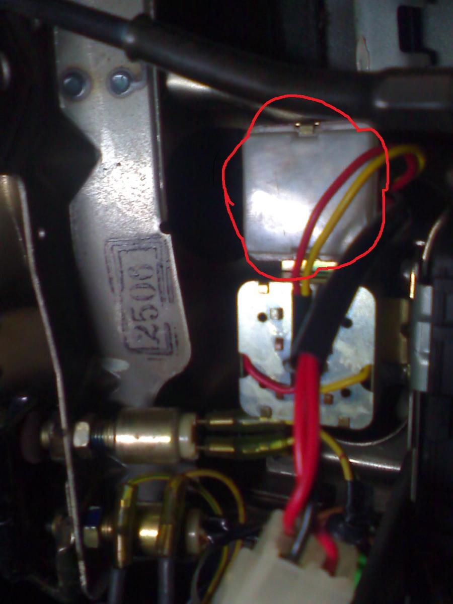

lol sorry i didnt circle it

it still clicked when my door was shut though i think

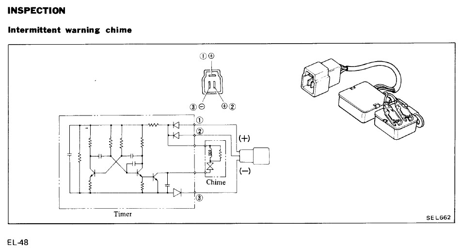

Door / seat belt chime............ This is info found in your Haynes manual or FSM.
Check your door pin switch (also located on the same page of the FSM).

lol ya i was trying to overcomplicate things it is but its never been hooked up on my car. the door pin sensor thing was crooked lol wow i feel like a dumbass
