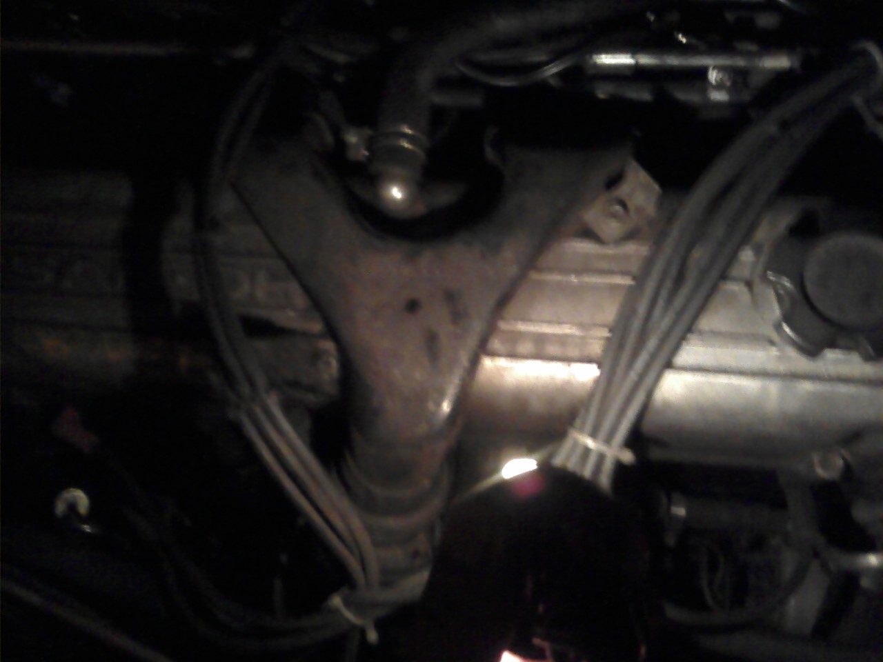

wat is this for
what is the proper function for this thing

its a cooling fan for the injectors

That's a 75hp boost. DON'T TOUCH IT!!!!

how important is the injector cooler, and if you take it out would the injectors be ok

would it effect the car

The injections system on the Z's had issues with boiling the fuel from what I understand. The only times I have seen them removed that makes sense is on an aftermarket built fuel rail, and injectors.
I am curious for a definite answer too. I think living in the heat of the desert, I would leave it on. But, I am curious how crucial it actually it.

proper spelling is great but wat ever now and then isnt a big deal but when typing a problem or question THATS when it becomes important just so we understand fully, i didnt see any problem with what you typed though so no big 2by2 is jsut a butt hurt adolescent haha. also the injector fans are a crock theres this SUPPOSED fuel boiling problem which is called vapor lock but i have NEVER had it happened nor heard of it happening and the injector cooler fan barely works on these cars so if you dont like it you can take it off and never look back. always try a search before asking but sometimes a new thread is needed. this is one of those questions that has been asked many a times though. no big your new and we are all cool people so dont get deterred just take a bit more initiative in the start if you cant answer it for your self after a few minutes of searching then go ahead and ask

So.. No vapor lock problems in hot climates as well? Why was Nissan so concerned with it happening? Not that manufacturer make all the right choices.
I remember a discussion on it being because of fuel quality in the 80's.
I don't personally see the point. I don't know of other cars having them either.

where does it take the temp. to turn the fan on and off

that sir, i have no freaking clue im guessing tied into the coolant system and just stuck on its own thing... whats it called... drawing a blank... ummm ummmm....
RELAY! lol thats it. i honestly could not think of the word haha.
Old Nov 8, 2008 | 05:03 PM
Thermotime sensor...

for real though im thinking of wireing my cooling fan to a switch if i ever get the motivation to put it back in...

Tony D and I had an at least 2 page thread about the issue with heat soak in the fuel rail and what not. I've heard that the 280ZXs shouldn't have an issue, but it still seems to be. Probably more so due to the fact that I removed the small heatshield that was on my exhaust manifold, and that my exhaust manifold still leaks a bit. Our engines with the intake directly over the exhaust especially on turbos can gain alot of heat. There's not a lot of room for that heat to go elsewhere. I've personally never noticed the cooling fan kick on, but then again it may be kicking on while I'm away from the car. That sensor does sit there and watch the temperature.
I've actually monitored the change in the fuel pressure from the heat. For a while there I just kept my fuel pressure gauge hooked up. I'd notice that after a minute or so after turning the car off the fuel pressure in the lines would actually start rising. You don't have the cool fuel circulating to keep the temps down, you don't have the coolant flow to keep temps down etc. For about 10 minutes maybe longer depending on the day the fuel pressure would rise from the fact that the fuel is becoming heated so much. Then after enough time as the heat had dissipated and the fuel could start to cool down the fuel pressure in the rail would drop alot, primarily from the fact that alot of it as it starts to turn to gas makes it way past the fuel pressure regulator. So really the cooling fan should be able to help. The best way to look at is, Nissan wouldn't have designed it for no reason.

mine worked for a week then stoped so i took it off, it was cool to walk away and hear the fan still going, people would be like "hey are you going to turn that off", id be like naw it does it itself.... oh snap!!!
