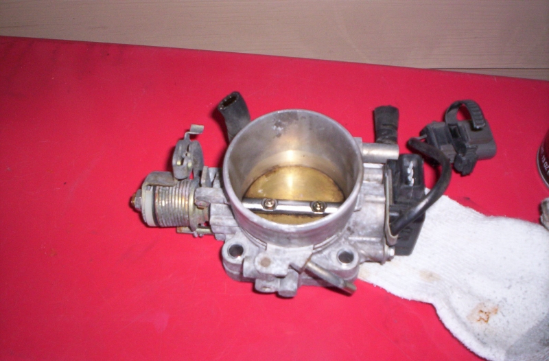

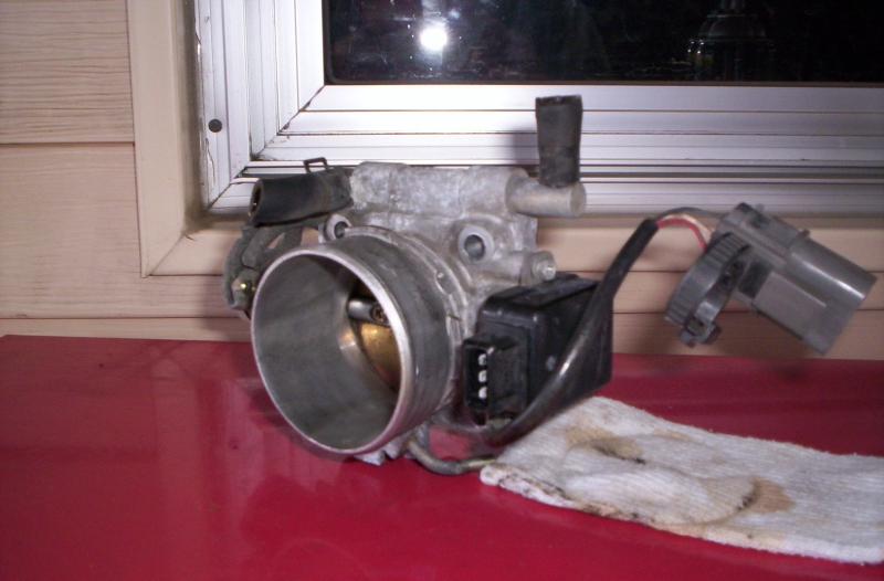

..well i just got a 240sx trottle body ...i looked for the spacer on ebay but i couldnt seem to find it ...there not listed right Now....
does anyone have one?.....also is there anything other than that i will need for this mod ? .for now iam going to clean this this beast up wit some carb cleaner ...

Posts: 5,485
http://www.arizonazcar.com/inject.html
$36.00

OK NICE J .thanks man ...i emailed him and he already ...he emailed me back super stoked ..6 bucks for shipping ....ok do i use the throttle sencor on this one or do i take the one off the z now and slap it on the the 60mm???? ... i think got the linkage figured out ..i can just swap the linkage arm and it will hook right on????..that is what it looked like to me anyways ...does anyone one have any pics of this set up ....i would like to take a closer look ...that way i dont mess up anything ..

it wont do anything if its not ported...i believe sombody did research and found out (maybe it was you Bleach, sombody told me anyways) that it was worse off then the stock if its not ported...

yup! It was WORSE without porting. The throttle will be more sensative, but you get more torque and horsepower with the stock throttle vs the 60mm and no porting. Especialy since you have no other work done and you're running a stock cam.
