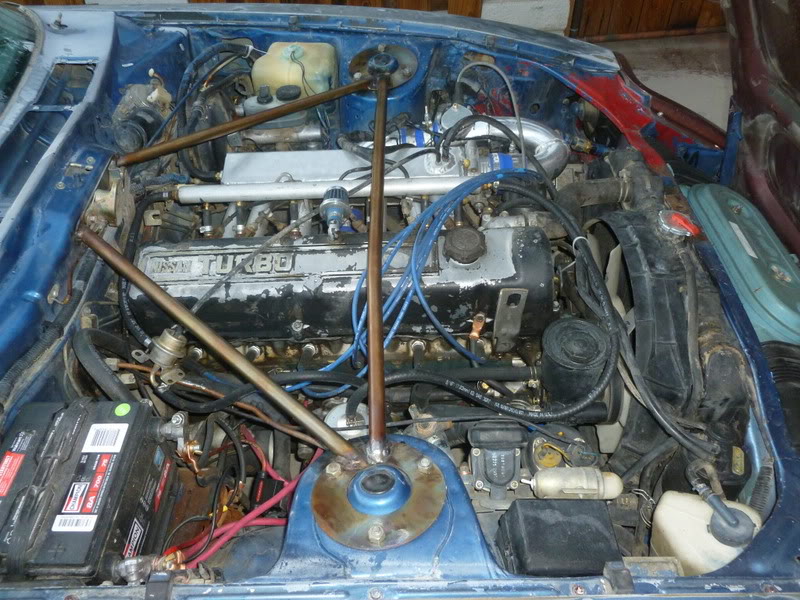

I used 1/2" stainless steel sch40 pipe and 1/8" plate worked great!!
evandubya Aug 18, 2014 06:05 PM
1 Attachment(s)
Attachment 15569

I you auto cross or even drive your car agressively you will notice the difference mostly with a front brace. A rear brace will help as well but not to the same degree that the front does. If you have a sloppy suspension (worn bushings/struts, etc) then you are also not going to notice the addition of the strut bar. I like Evandubya's setup as it helps to stiffen the front end even more.
Think of it like a cardboard box with the top open. Close the top and tape it shut and the box becomes much more ridgid - same with strut braces as you are completing the box shape of the suspension rather than having the top opened.
