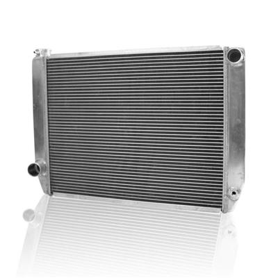

You can get this guy (biggest one for the price) for $189 from Summit
19in high, 31in wide, 3in thick. Listed as circle Track Griffin radiator.
Part # GRI-1-26272-X
