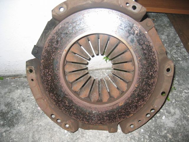

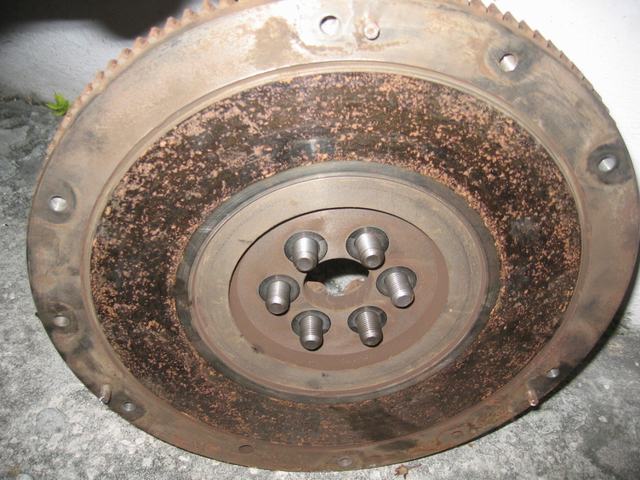

I have the flywheel from my spare '82 ZX and it's in very good shape. I don't know if I posted those pictures.

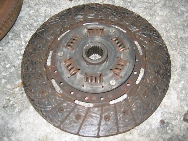

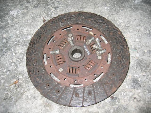

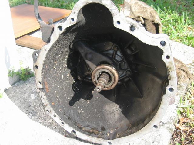

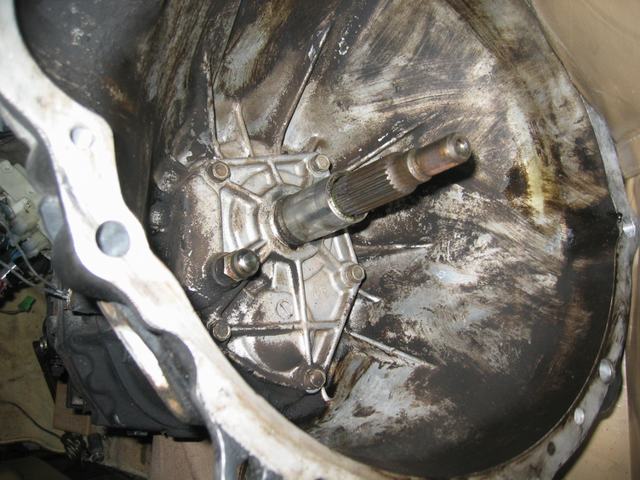

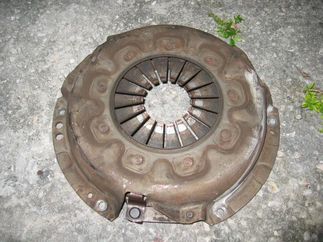

Ok, I'm going to continue this thread and ask a few more questions.
So, I got a the following parts new:
1. Clutch kit
2. Clutch cable
3. Master and slave cylinders are new
4. Clutch fork and fork boot
5. Sleeve w/bearing
6. Pilot bushing
All these parts will be replacing the old worn out parts in this '82 tranny.

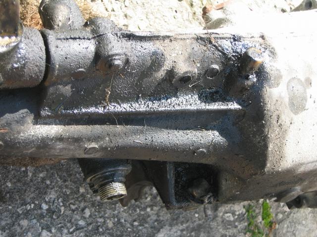

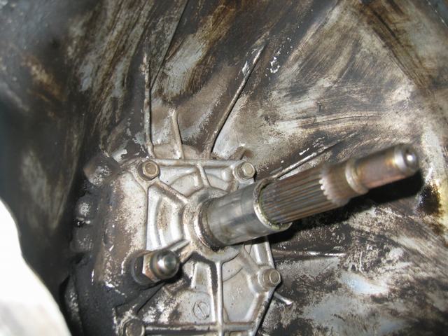

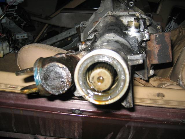

Questions:
1. Should I replace the rear oil seal?
2. If you look at picture #2, should I replace that breather cap? It look as if leaking transmission fluid from there.
Once again, thanks for all your help guys.
Here are the pictures of the transmission.

if it leaks replace it... also new fluids should be added to that list for that tranny. also in your list i didnt see a flywheel... or is it part of the clutch kit? might wanna make sure.
