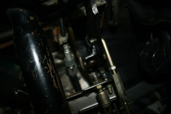

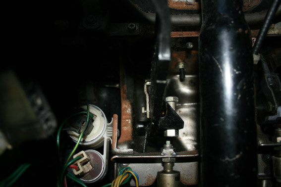

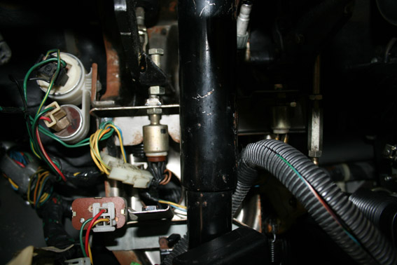

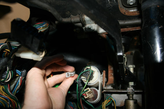

ok i looked and as you can see in the photos (sorry about focus as it was shoot and hope for focus points)as per the 1st photo i only have 1 per pedal, 1 brake and 1 clutch. 2nd and 3rd photos you can see me press the pedals for the plastic part to pop out. now something i noticed as per 4th photo was the wires from both pedals switches all go into a loom now a bit further up wires come out of that loom and into the two "canisters" i'l call them next to the brake pedal. now out of this loom is also a plug connected to nothing with a green and green with blue stripe wire. whats this for or is it something not used in my car ie something for an auto or overseas markets
