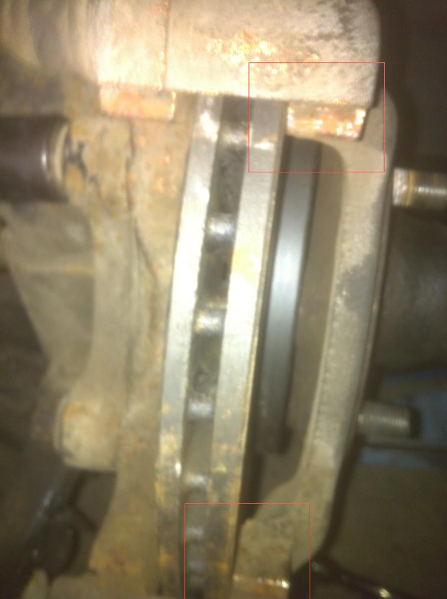

I thought a photo would be helpful, I have highlighted the areas that are caught. I have reassembled exactly as I found everything but it looks like the rotor is shifted to the right. Could the previous owner forgot to include any parts?

Is the Hub and rotor inserted all the way in?

It seems to be, the nut holding the hub on cleared the hole for the pin but I'll confirm tonight after work.

One hint always take pics before you dissassemble. when the son and I did the brakes on his chrysler sebring we would have had a dificult time getting things back together without reference pics. I'd maybe call around and locate caliper at auto parts store and then compare those to make sure the caliper is standard. and as corbith said is the rotor mounted correctly?

Just as an update, this was caused by an oversight on my part... I put new wheel bearings in while I had the hubs off and apparently didn't have the metal bearing cone properly seated for the inner bearing.
