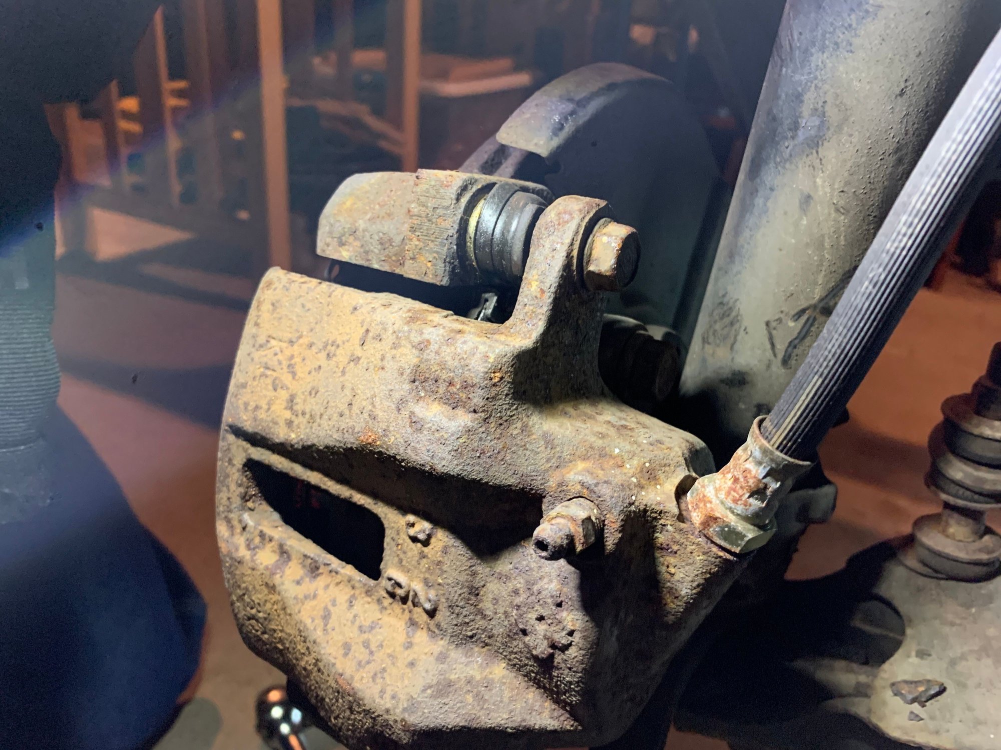

The front left is totally complete. (Of course 5 years old.) But new lines, new pads and new slide pins.

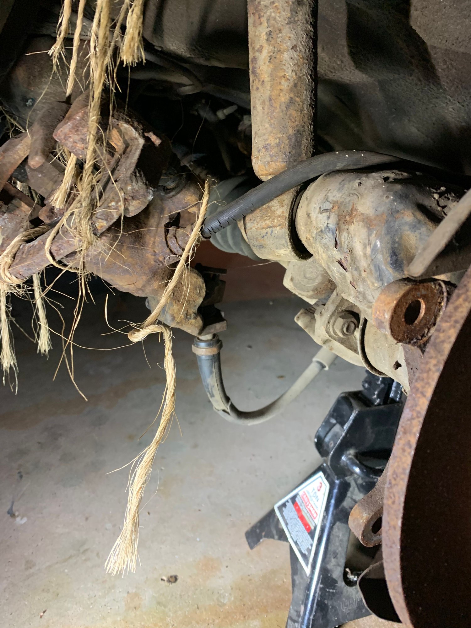

Right front is completely missing from the hard-line forward.
Both rears have been tied up. The only parts that look to be missing are the caliper mount bolts. The rest seem to be there.
