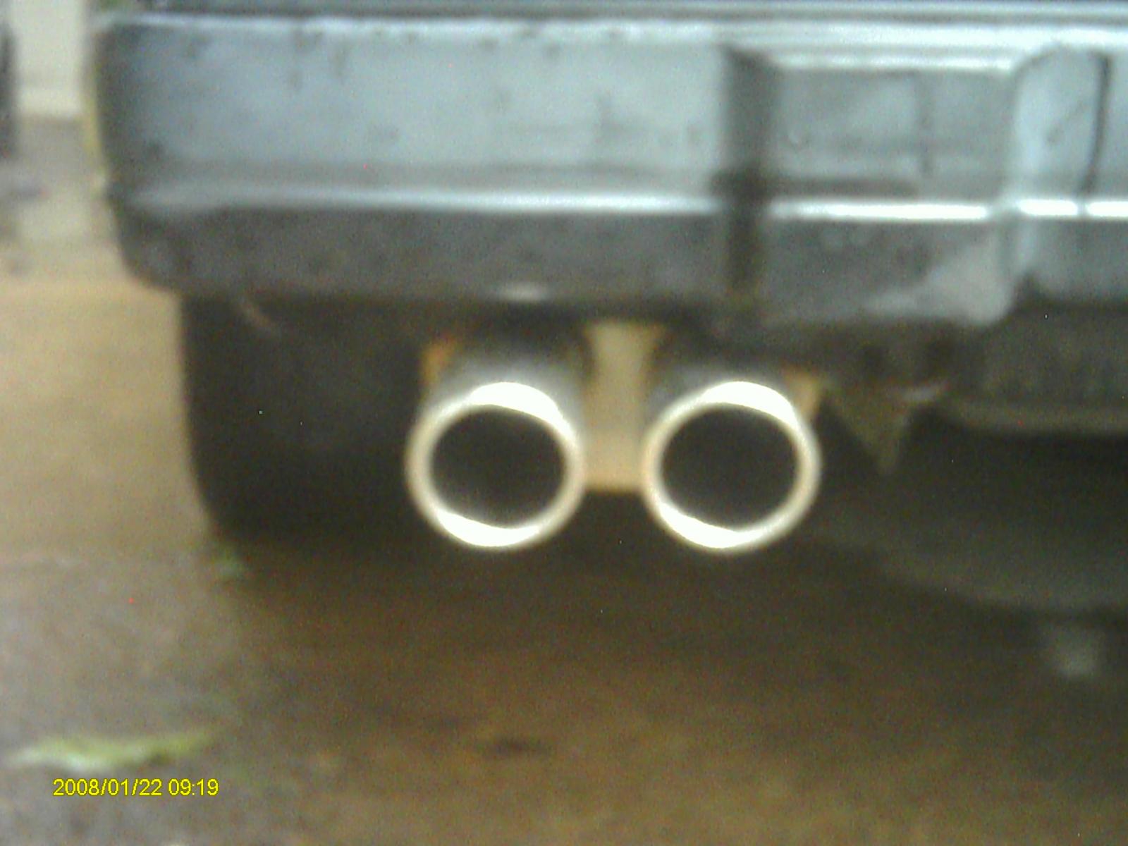

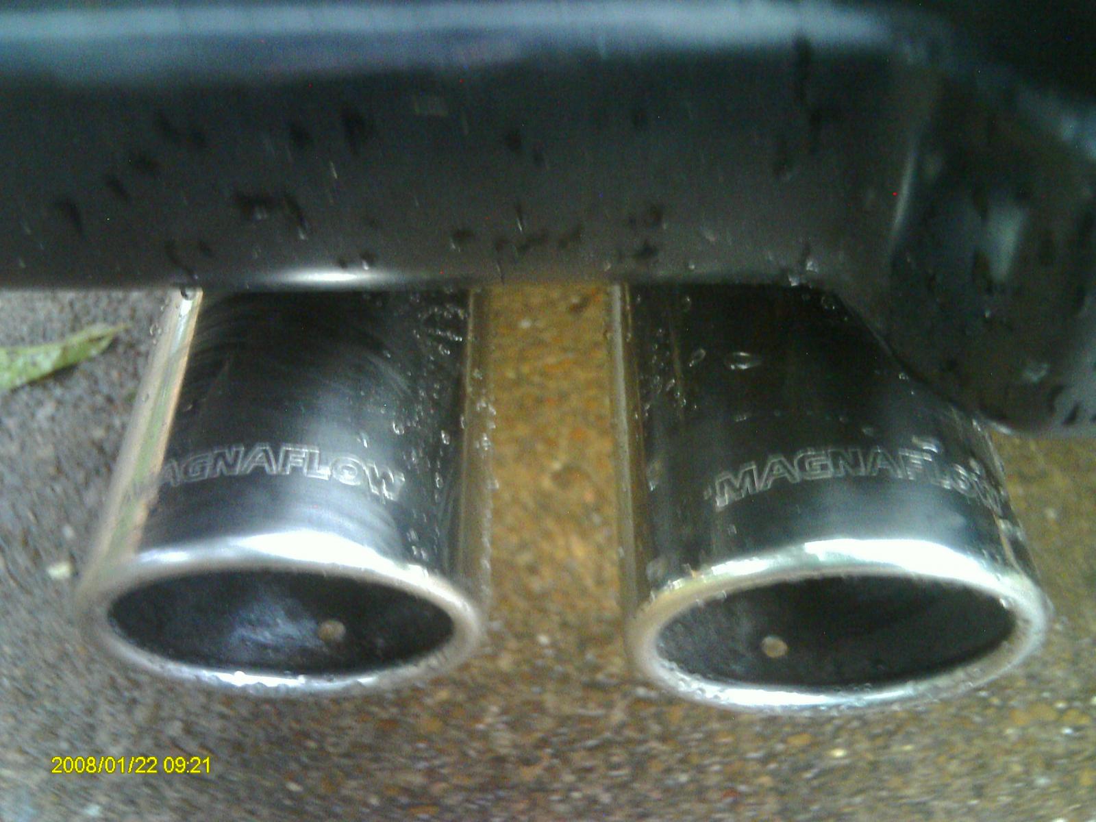

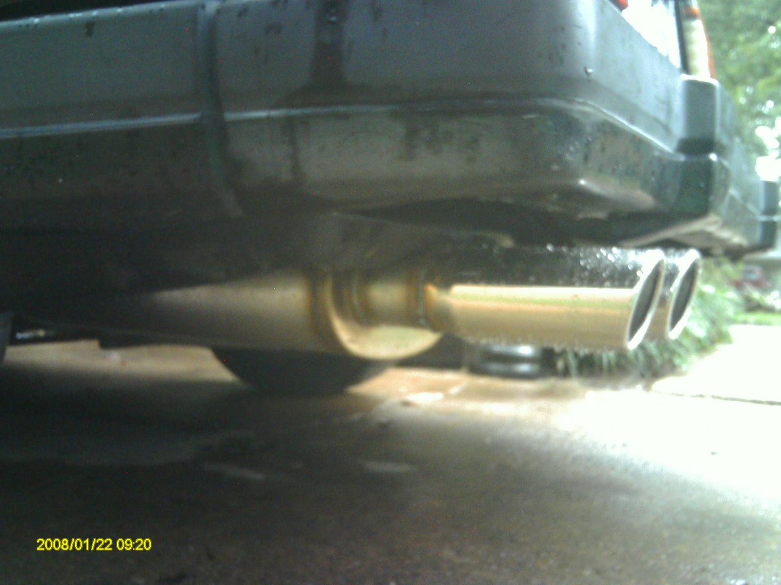

3 hours later, new exhaust with Magnaflow muffler and tips, looks very nice I might add...
