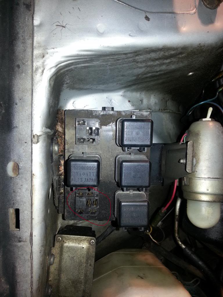

ummmm ok so I take a gray relay out of the box that is front right of the car, and now all of a sudden, my dash, running lights work???? how many relays are supposed to be in that box? I had 5, with the most front right being the one I took out.
Attachment 16243

ok I've been utterly stupid with posting all of this. with trial and error I figured out that by squeezing the big connecter under dash, the dash lights come on..loose connection in plug? anyways got my speedo working, tach still doesn't move, put in corner lights, coming along so far. Seems like the more I look, the more rust I find. I've never owned a rusty car before and don't know if its worth to restore. rearend seems to be caked with something, doesn't seem to even wants to burn out, 2nd gear seems to go quick, shifting into third.
