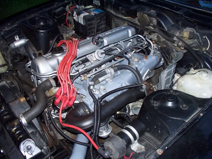

I want my intake mani to look like this
Old Apr 8, 2010 | 11:16 AM
That is a non-turbo intake manifold so no block-off plates are on the top of it like you would have on your turbo manifold.

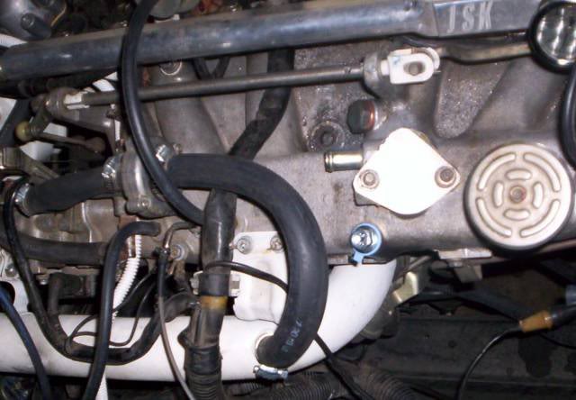

Sorry wrong pic. More like this but what could i use to plug the whole were the pov is?
Old Apr 8, 2010 | 12:56 PM
^^^ That's Bleach's.
Clicky: https://www.zdriver.com/forums/showp...ostcount=10049
Use a plug from your local hardware store.
Old Apr 8, 2010 | 02:53 PM
I think I heard a trick for plugging that POV.
The intake manifold of a Z31 has a screw in plug in it that fits the 280ZX manifold in that spot. Just take one from a wrecking yard.
Yeah, this hose design is genious! If you can get the bypass valve out, the bolt blocking it is the L-series oil pan plug.
