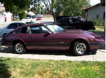

pic of my zx
Attached Thumbnails mechanic/parts-280zx.jpg

s/cL3.0's Avatar
Bleach is my Hero
Posts: 1,293
Welcome, and I like your car
Old Nov 11, 2005 | 10:29 AM
RodMoyes's Avatar
Doesn't post much...
Posts: 3,617
Yes, welcome and Nice Car!
Rod.
