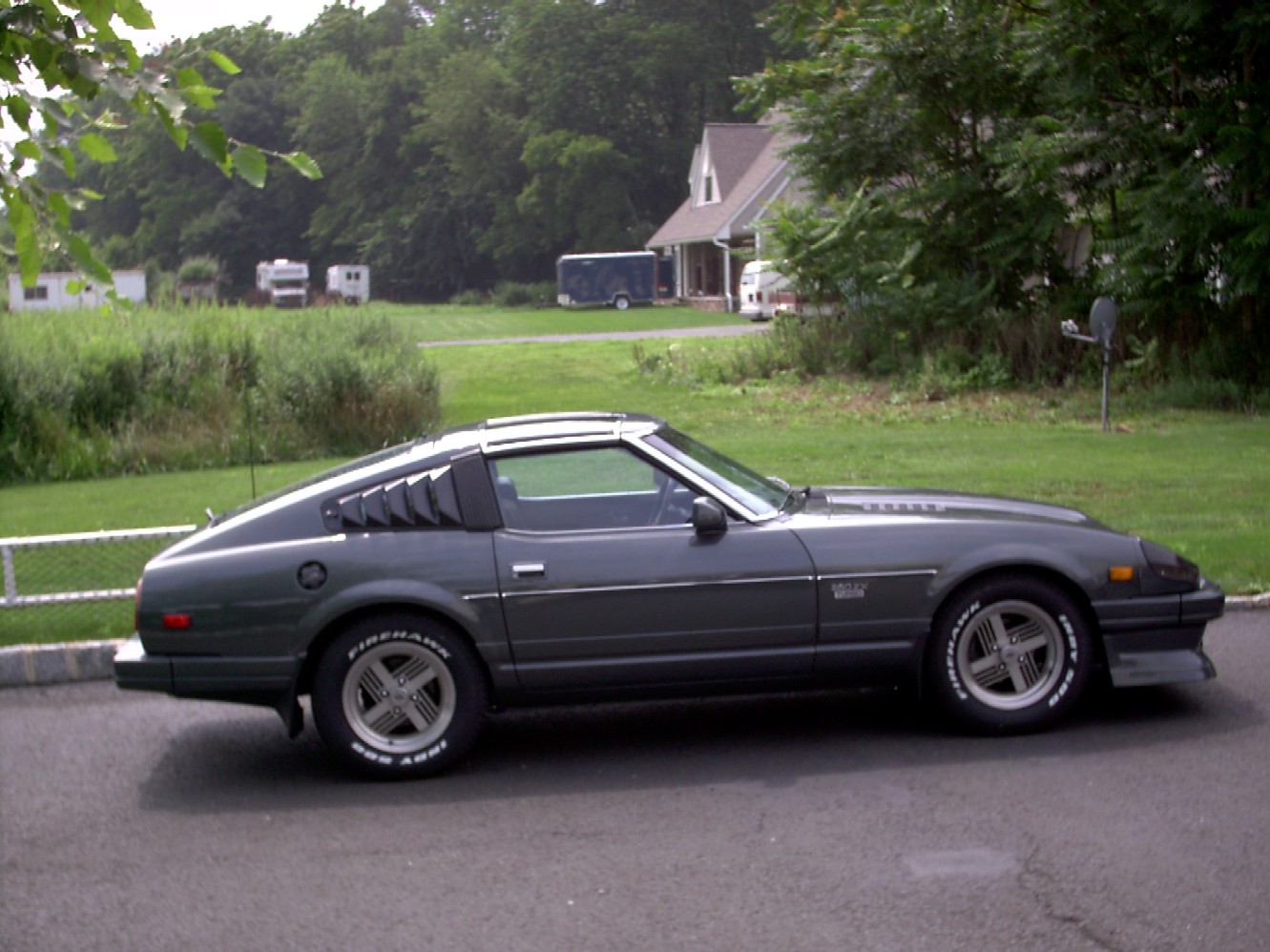

My 82 Turbo automatic coupe has recently been consuming oil at the rate of about 1 quart every 250 miles. The car does not leak oil or anything else. It has good power and starts up fine, except for some blue/gray smoke, which clears as the car warms up. I ran a compression test with a hot engine and WOT and got the following:
Dry After adding oil
#1 145 155
#2 145 155
#3 150 160
#4 150 160
#5 150 160
#6 150 160
My research here and other places, as well as 'my' mechanic, tell me it's probably valve seals. I've seen the procedure on the internet about replacing the seals with the head in the car, but with 120,000 miles I figure it's a good time to get the head rebuilt. Then, since the head is off the car, I figured I should rebuild (and jet hot) the intake manifold with all the emission and cold start stuff, replace the injectors, and get the turbo rebuilt. In total, after pricing all the parts, rebuilding, and other costs, I'm looking at about $2000, including some "bling". My mechanic says he wants $1000 for labor if I supply all the parts.
My question is, is this a job that a 'home' mechanic can do in a garage? The head and turbo rebuild I would farm out. I know about the timing chain tension tool. I am pretty good but self taught working on the car, but this job would be my most ambitious project yet. I have the FSM, Haynes, and the Monroe rebuild book. I would like to do the job over the winter - the car's off the road for about 4 months anyway. My biggest fear is breaking frozen studs and bolts. I really like working on the car and want to do as much as possible myself, but don't want to get in over my head.
Am I nuts? Does the above make sense? Should I just pay my mechanic the $1000? Any thoughts would be appreciated. Thanks.
