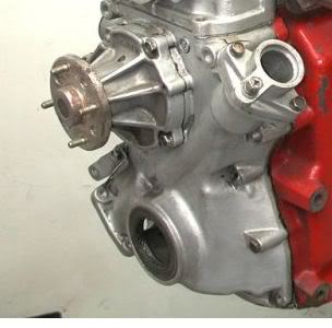

with the engine still assembled, how do you rip it off? Isn't the crank in the way? (fyi i have never seen an L28 in person so I'm going by standard IC engine conventions) to my knowledge, the seal goes around the crank between that and the block. Ive included a picture, I think its the ring right below the water pump. Please let me know what you think
