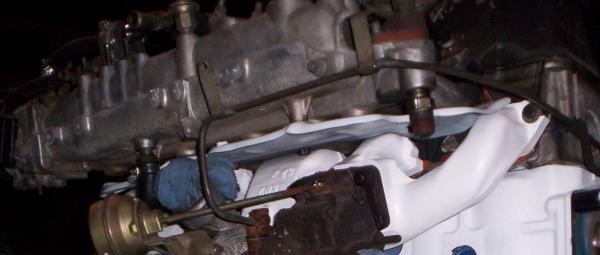

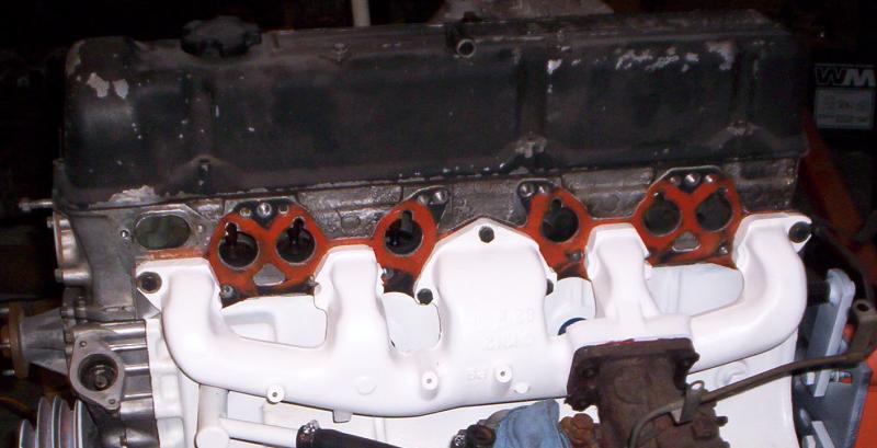

disconnect the EGR pipe from the big bolt on the bottom of the EGR... or just unscrew it from the manifold. I couldn't get that big huge bolt out of the intake manifold either.
There are six bolts that you need to get out that share the flanges for the intake. You can see the three in the middle hold only the exhaust. These are pictures of my engine out of the car. the turbo and NA have the bolt locations the exact same way.
