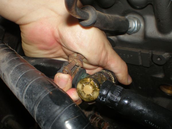

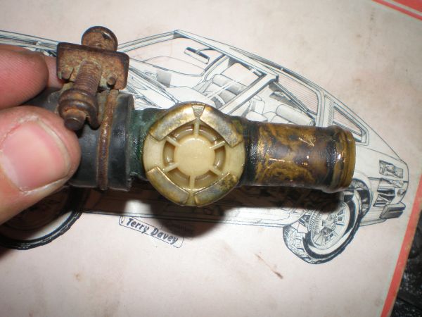

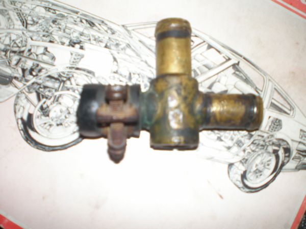

Ok so I found the source of the leak, drained the radiator and and ready to replace the part. Only problem is I have no idea what part this is or where the best place to get a new one would be.
And yes I had to cut part of the hose because the screw was stripped.

It's a "T". You can get one from Nissan, AutoZone, Checker, Kragen, Napa, the junk yard, etc etc etc. Or you could probably make your own.

<used to be the same. but orileys got used to the Z seeing it out side when i came in. I droped all that t stuff. more connections, the more prone to leak. Don't get another one with plastic. all metal.

Let us know where you find one. Mine leaked too, but I just put JB Weld all over the bottom of it, covering the plastic/metal junction. I wasn't sure if it was anything more than a "T" - it looked like it had some kind of valve on the inside so I didn't want to replace it with something different.

it does have a valve in it. serves no real purpose. just replace with reg T. and let the engine get better cooling.

Most all the parts stores have basic coolant T's. Bring yours in, match the size, buy the part, install. Wa-la!
