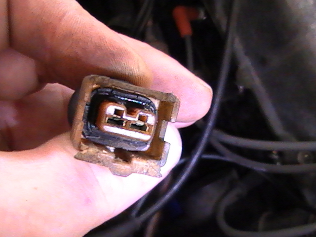

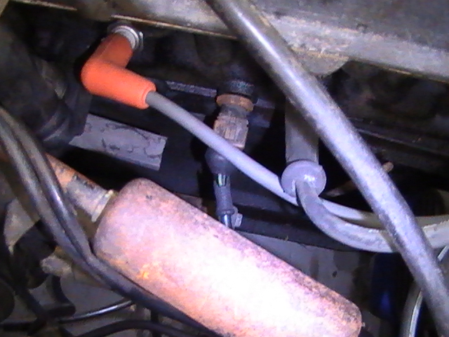

Well looks like I might have 1 after all, right between 5 and 6 just a little underneath it. You tell me. Posted pics, think I did it right!

Old Dec 19, 2007 | 08:33 AM
RodMoyes's Avatar
Doesn't post much...
Posts: 3,617
^ That's it!
Try and clean the contacts first before replacing it.
