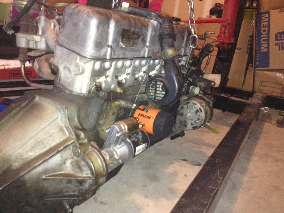

End of day 2. Took some time but it is finally out and should be starting the disassembly today.
