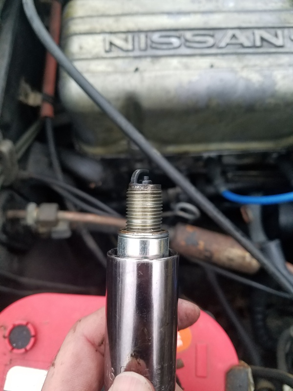

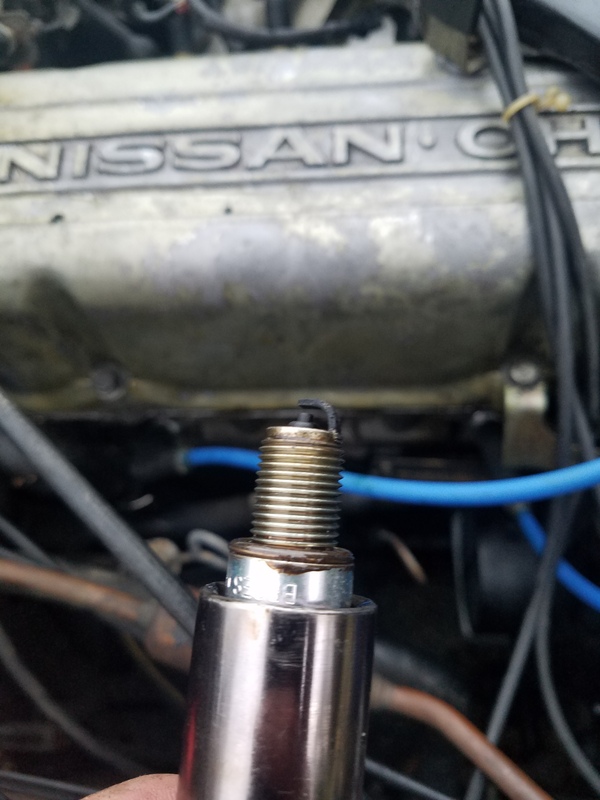

So my daughter's car stopped running on her way to school yesterday morning.. she was able to get it restarted and limp to school and I went to take a look and pick it up when i got out of work. It died on me halfway home and had to be towed the rest of the way.
Upon interrogating her, she said it's been hard to start in the mornings and sometimes, she'd be cruising at 35mph and it would slow to about 25-30mph and she would have to give it more gas to get it back up to speed. She said it had been doing that almost a month, but she thought that's just how old cars are...
Here's what I've done so far:
- verified gas is flowing
- checked spark plugs (pics below)
- checked distributor cap
- checked ignition coil
- kinda half assed checked for vacuum leaks
The distributor cap did have a lot of chunky white corrosion on the contacts. after chipping that off, it started a little easier..
I swapped the stock coil for an msd blaster 2 coil and it didn't help or hinder anything.
I ran it with the oil cap off and it ran a tiny bit better, but hardly a noticeable change. (that's my half assed vacuum leak check.. as far as I know, if it's got vacuum leaks, it'll run better without the oil cap in place..)
it's got coolant and oil.
judging by the uniformity of the plugs, I'm not thinking it's a head gasket. none are cleaner or dirtier than the others.
any advice would be appreciated, i don't even know where to begin at this point. I'm scared to bring it to a shop because we're a little low on funds right now, so if i can handle this myself, i'd rather do it that way..
plugs:
1:

I'm a victim of a broken connector..
I did dry compression tests today after work (all cylinders 200-210 psi) and while pulling the plugs I noticed that the CHT connector was ****-eyed.. it's missing the little metal clip that holds it on, like most of these connectors on this car, that broke who knows how long ago..
anyway, after putting the plugs back in, i made sure that was seated and fired it up, and it's running fine now.
Gonna drive it to work tomorrow before giving it back to the kid, but I think that was the problem.
feel like an idiot.. haha
