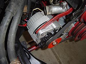

I'm trying to check timing with the light but can't see the Mark's on the pulley. I see the teeth beside it on passenger side. What kind of mark will I see? V cut mark or just a line on the pulley? Thanks in advance
Old Jul 24, 2018 | 08:51 AM
You can feel around the back edge until you find the V-groove... then mark it with whiteout.
