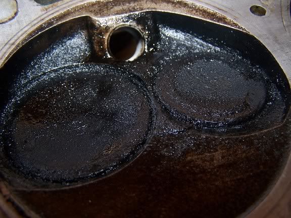

so i took my n42 apart...and i took the cam out...i tought cams had bearings like the crank does...i didnt know the cam mounts are just one aluminum piece...so if i get a turbo cam, will my aluminum mounts work with it?? like are the cam grinds just different or are the mounts different too??!?!! i need a BAD valve job..there is **** baked on there left and right...layers of carbon...god that engine never ran right!

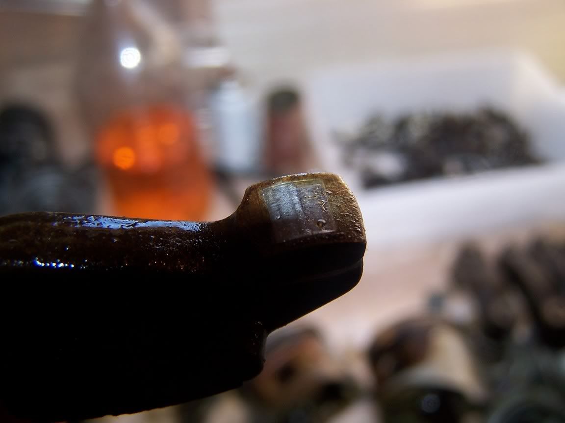

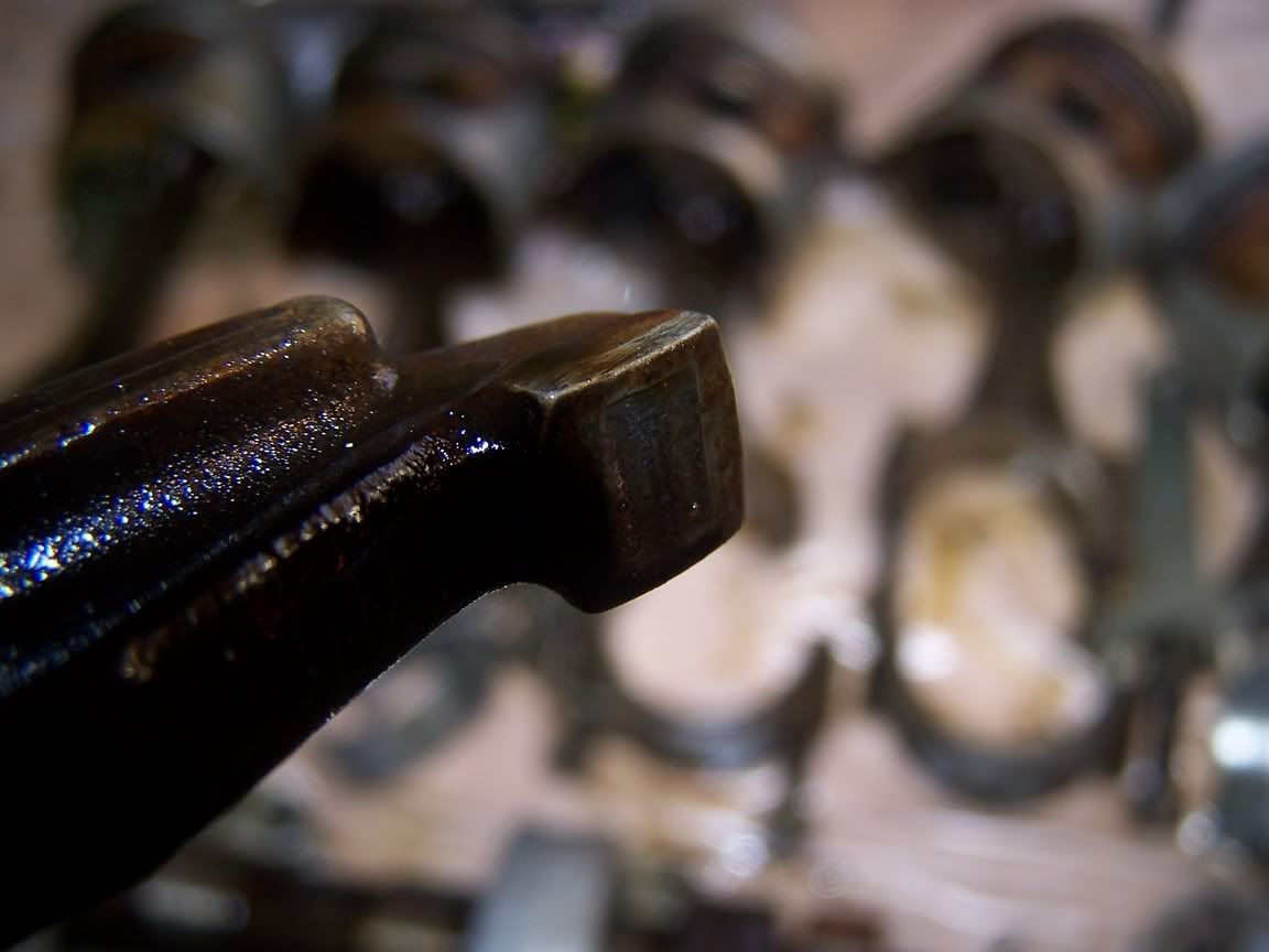

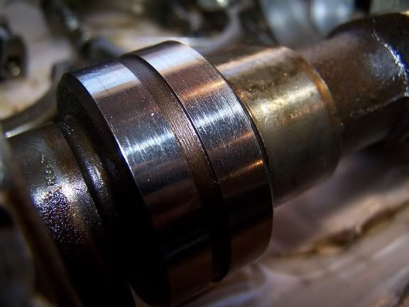

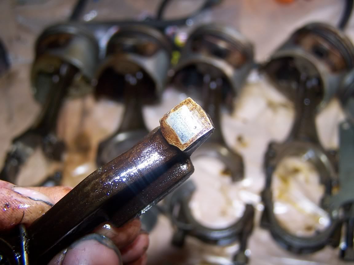

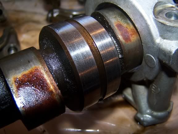

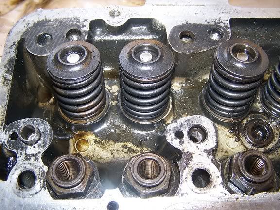

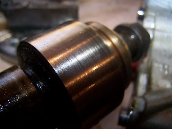

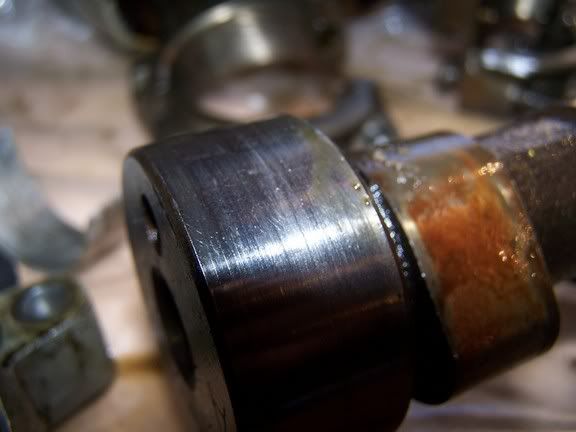

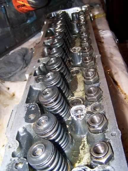

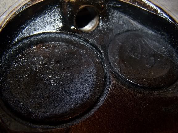

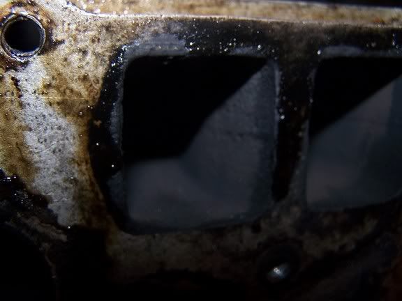

here is some pictures..... i need to go and get a spring compressor so i can take the valves out...
just click...
My Larger Plug hole...its already larger...and was leaking...so...make it more large??!!!
CAM SHOTS
EVEN WEAR
