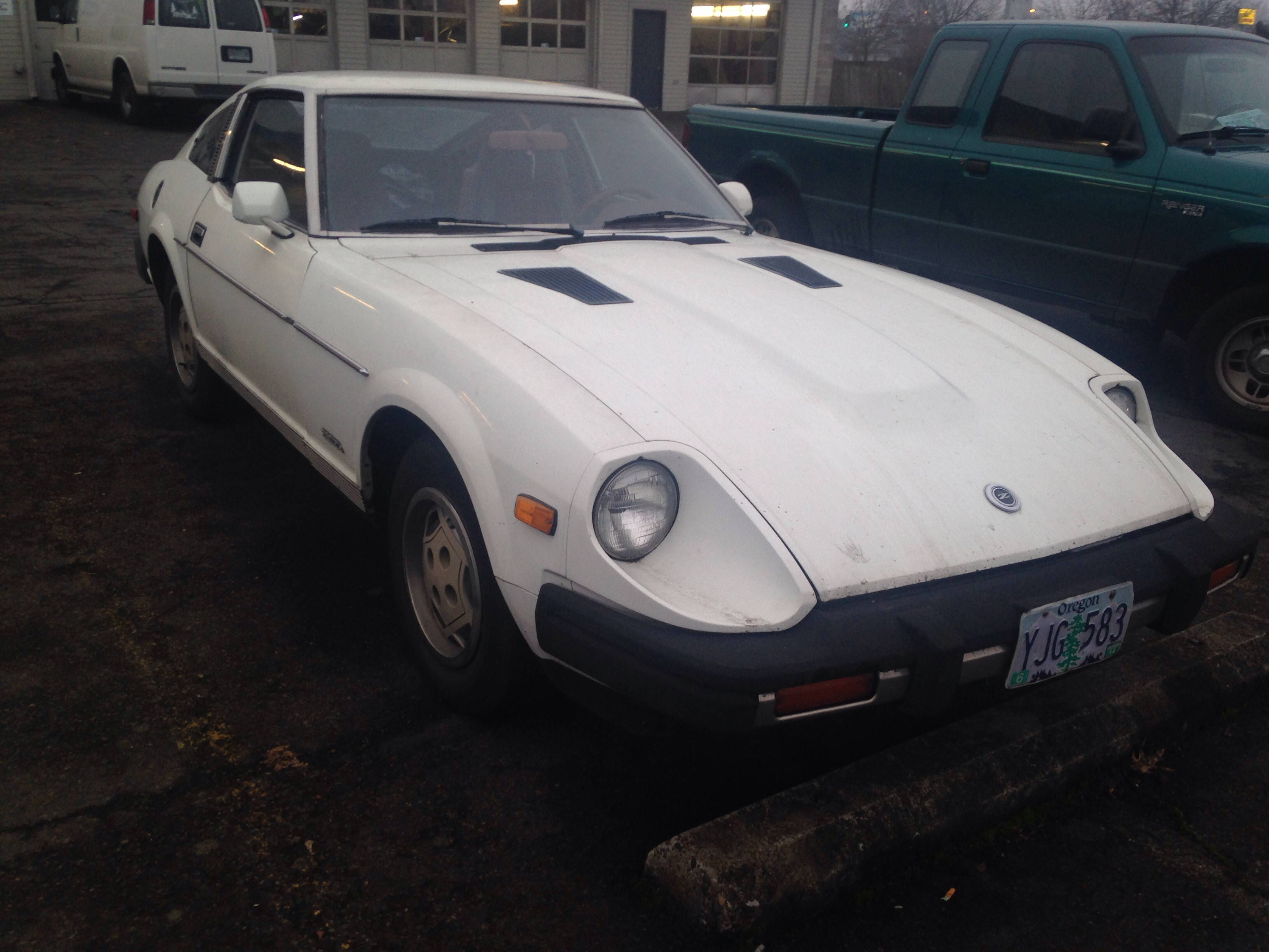

Mmmk.
Got this gorgeous broad for free from a friend who no longer wanted to deal with it.
Long story short, after installing the new starter, the motor starts up, idles like **** for around 10 seconds and promptly dies, especially when applying throttle. When I was tooling around in the engine bay, the cover fell off the AFM, I manually moved the valve open to a middle setting while the motor was still firing under it's own power and the idle speed picked up, albeit shakily, and idled fine until I let the valve go back to its resting state.
Where do I start? It must be a fuel delivery issue, but as it is getting enough fuel to start and idle when messing with the AFM, I can't think of where to start. Cold start valve? Pressure regulator?(Which is new) Damper? Injectors? ECU? Wiring somewhere?
A little bit of backstory, the previous owner gave up after running the car to empty. Rust was pulled up from the bottom of the tank, which I have now pulled out, cleaned, and re-sealed with RedKote. New-ish fuel filter, new starter, new pressure regulator.
ANY and ALL help/suggestions are deeply appreciated, I'm stumped and inexperienced.
