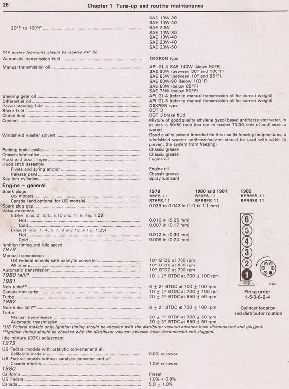

1 Attachment(s)
Nifty write-up in the Haynes / FSM. :D
Attachment 17593

NismoPick May 12, 2012 08:25 PM
1 Attachment(s)
Hot procedure is the same as cold... just diff specs. Rags prevent oil from going all over, but there will still be a mess... what were you expecting?
We've discussed how to adjust the valve lash many times... so feel free to search.
Here's another Haynes scan for ya with the hot & cold specs:
Attachment 17592
