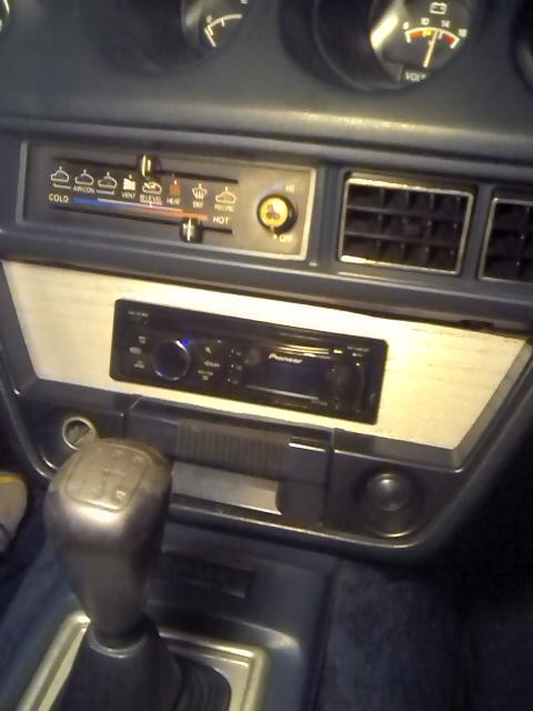

well, heres the update with the radio,...still need a bit of advice.
i made my own custom faceplate out a nice piece of red oak,..painted it and custom fitted it to the original braket/radio frame...and popped in my new radio.
i cut up my original wiring harness in order to make a new connection for my new radio, ran new wires to the rear speakers,...i also hooked up my subs that i had kickin around for along time doing nothing, everything came out great and it sounds great except i have no operational front speakers,...since my wire harness is now a mess, could i just take my rear speaker wires, splice em and run new wires up to the front speakers? or should i dig into my harness again and try and figure it out?....the reason i ask is because it will b a million times easyer if i just could splice and run new wires off the rear wires.

i wouldnt splice the rear speakers togather with the front for front speakers i ended up building custom door pods and mounted them to the door panel i built them out of fiberglass in about 3 days they sound great

As for the OP. Run new wires from the head unit to the speakers. Don't use the factory stuff, or run wires from the rear speakers to the front. You won't mess up the head unit with improper impedances or crossed/mismatched wires.

i made the pods to fit over the outside of the door panels so the clearance inside the door isnt an issue just make shure your wires have clearance so they dont hit anything
as for the wiring i ended up running new wires from the head unit to all 4 speakers
